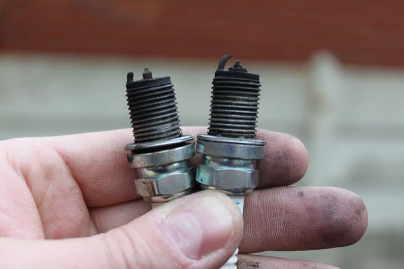

Ok commence the attacks on me ! I feel like such a pratt, and all because i didnt have the right size plug socket.

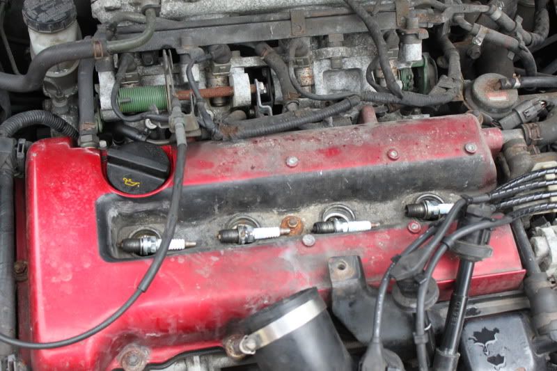

I put a new dizzy cap and rotor on, changed the air flow meter, then did the plugs.....................
