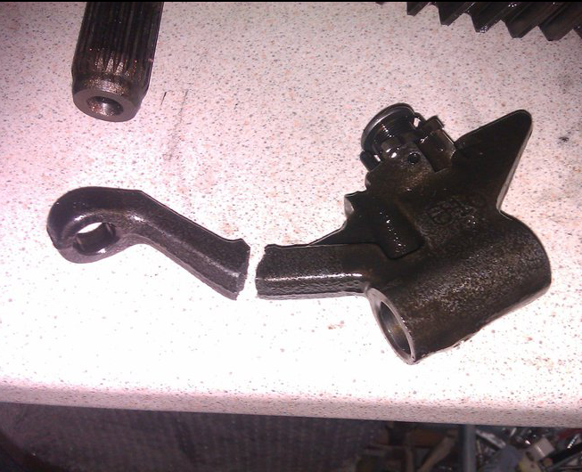

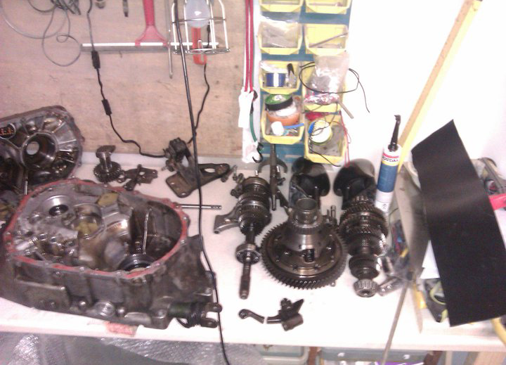

I broke the rod inside the box.
But there was absolutely no feeling in the gears. I thought I broke my linkage.
I had to remove my box and strip it down to remove the dowel pin that holds on the stricker rod.
