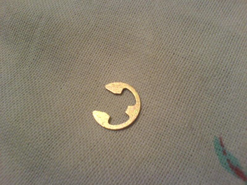

looks like it's the clip on the wastegate/ pipe that has come off, can someone show me a picture or tell this dumb bugger (me) where to look----->Thanks
Is that the picture of yours or a reference picture?
I lost the clip on my old car and used some locking wire from work. It lasted as long as I had the car, so it works.
Not sure if you can get to it in situ or if the turbo needs to come off. Send a small child in to fix it.:lol:
JIMMYBACK
if the heat shelids are not in place then you can just get you hand behind to attach another circlip trouble is where do you buy then from i had trouble when i needed one
andrew
fast guy its a referenece picture, my bloody tubular mainfold is in the way and i can't get my big hands through.

cheers guys all now sorted for the sake of a 1p (but i got for free from nissan, lol, shock) circlip (c clip),
so decided to try my luck pop into nissan as i knew a guy there from back in 1999 james kasim who used to own a 450bhp pulsar.
After 10 mins he got me in, all done for free. by nissan....
here was the missing link...end of actuator rod now in place and back to 1.2 bar boosting...
http://i76.photobucket.com/albums/j11/20legacy/DSC00599.jpg
