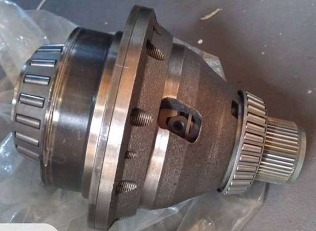

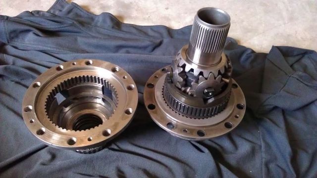

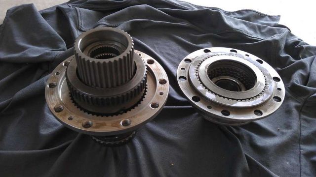

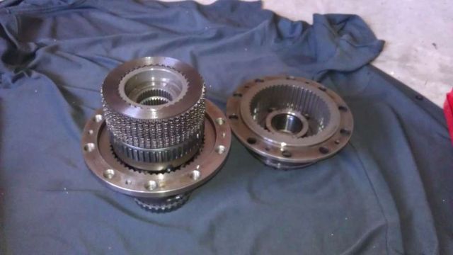

Well , I think that a lot of of us would love a center disc style lsd.
We have been in touch with Modena Engineering for this,but it has been a while and I don't think this will ever happen.
Modena is very busy and they are having huge business with racing team so cheap gtir guys are not the ideal customer.
There is a local company here that can build us a center LSD.
They are well respected in Italy and only doing gearsets and LSD for racing cars.
The name of the company is Bacci trasmissioni.

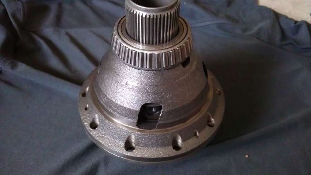

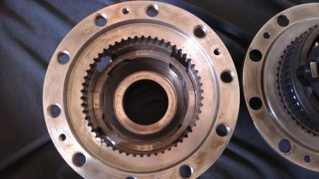

They could work on a design from scratch, or if someone could borrow a Nismo unit,they can copy it straight away.
They have a 3 D scanner,and full equipment to machine gears case etc.
I have been chatting with them about this and it is very possible.
Do not have a price yet.
Going to send them my center diff next week and go from there.
The question is,how many owners would love a diff?
