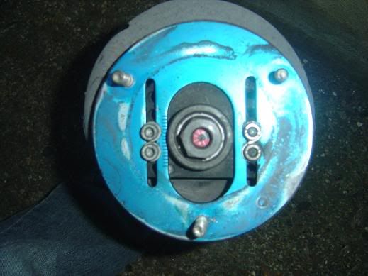

These are my old cusco pillow ball top mounts 8)
nd are adjustable :)

what does the pillow ball actually adjust? Ride height? hardness/softness?

It moves the shock from side to side so when you drop the car on coilovers you can set the shocks to keep you alighnment right 8)

think you will find that the konis, being just an insert are not compatible with camber adjustable mounts on the rear.
