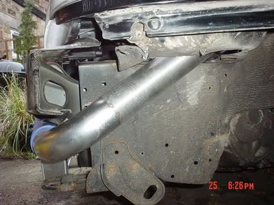

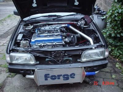

new hardpipe kit
kirko
todays efforts :lol:
not finished yet im gonna modify the induction pipe next and then move some stuff around the engine bay
S

Cool.... 8)
How long did it take you to fit the pipe work?
kirko
ive actually fabricated the pipework from scratch took me a couple of hours
but its good because it goes exactly where i want and is quite direct
so will fit round my other modifications
looks nice mate is it all compleat pipe from end 2 end NICEWORK :D :D :D :D :D

kirko said:
yes its all complete no joins
its going to be polished tomorrow
did u cut hole out 4 pipe 2 run throw & what size is pipe work mate
JIMMYBACK
:D love the pipe run did u have fun cutting most of the inner arches out to fit the pipes for the front mount :D
Dan_GTiR
That looks smart Fella :)
The sort of thing I need for my cooler ;)
Did you use stainless or aluminium pipe and what diameter is it :?:

kirko
yes i chopped the hell out of my car :roll:
actuallly i cut out the bare minimum its quite neat when the engine bay is finished i will post more pics
im pretty sure the pipe run is shorter than what forge provide 8)
it helps being a stainless steel fabricator :wink:
edited to say its stainless 63 mm tubing
