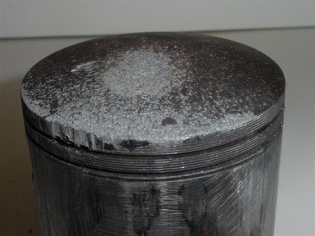

new engine 400 miles and cp pistons looked fuc@ed
nimhbk
what could of made the top of the pistons look like the moon they have craters all over them
no burn marks or carbon.
looks like it going to the scrap heap in the sky lol
detonation nick, too much ignition advance or not enough fuel or both, give us a piccy and i will be able to tell more.
yep det, check the plugs to make sure none of the porcelain bits have burnt away as they will pebbledash the pistons and the head too

put a pipe cleaner down the spark bores and it looks like a lot of the dimples and pitted bits are residue as the pistons cleaned up nicely well abot 5mm sq anyway
new sparks plugsafter a mile the tips have gone white and carbon up a little
