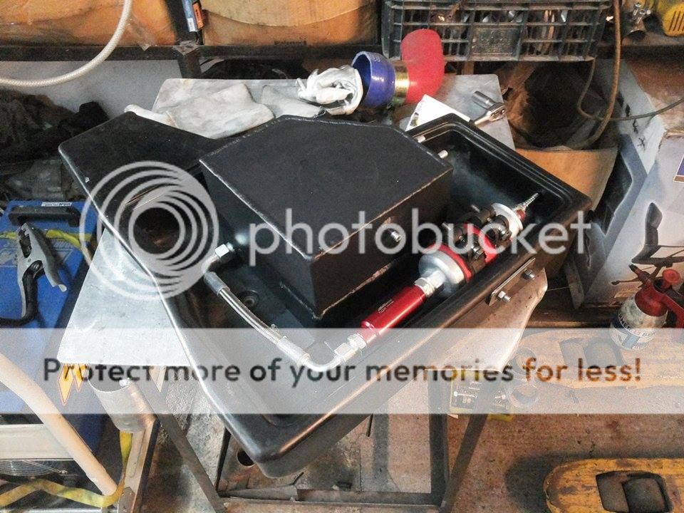

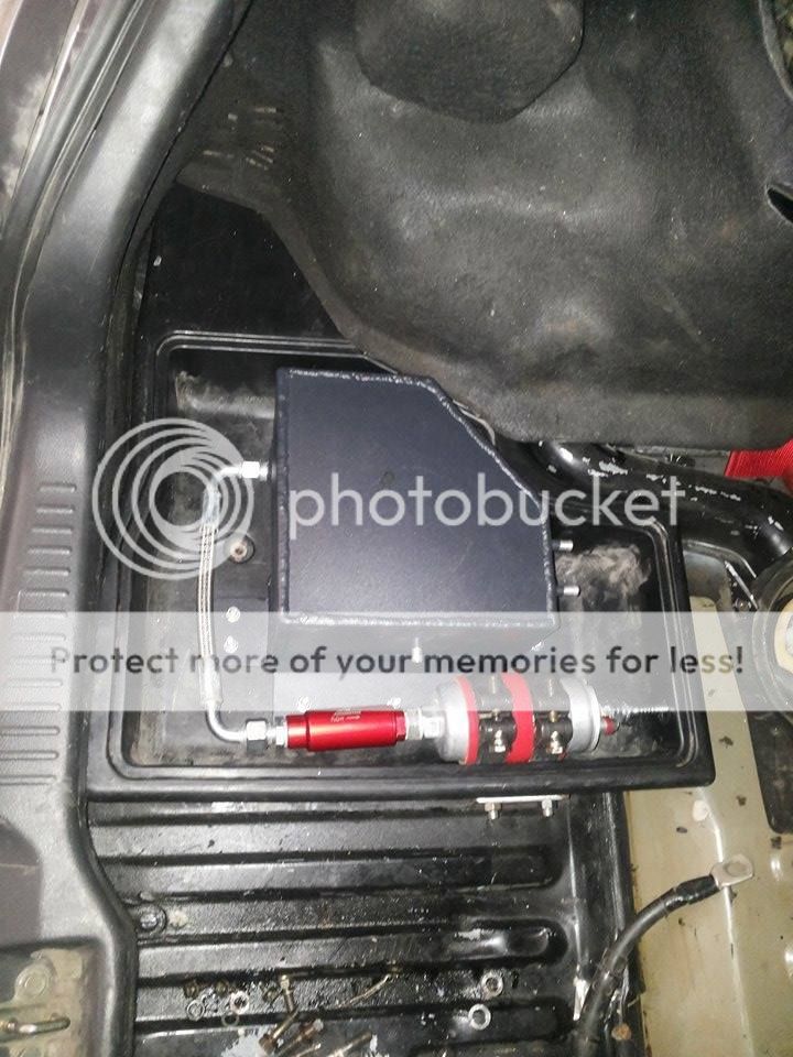

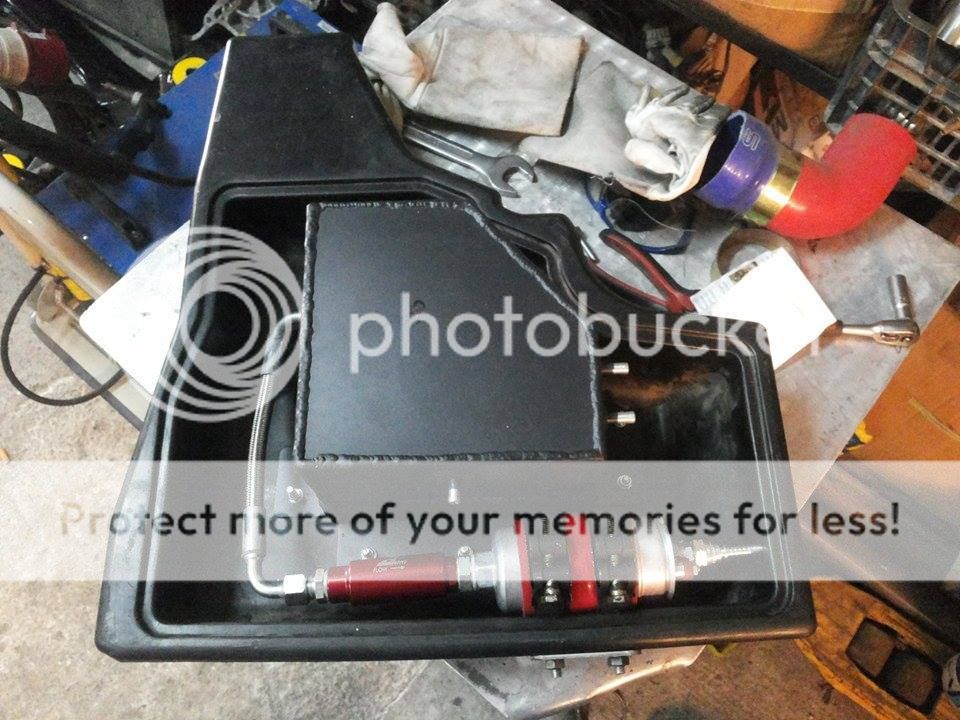

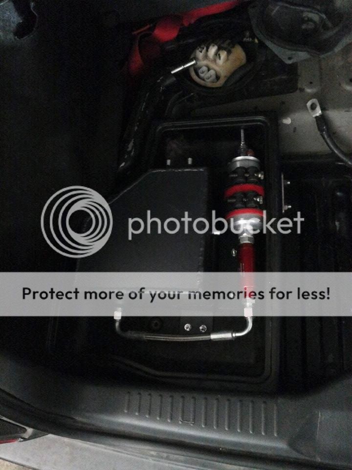

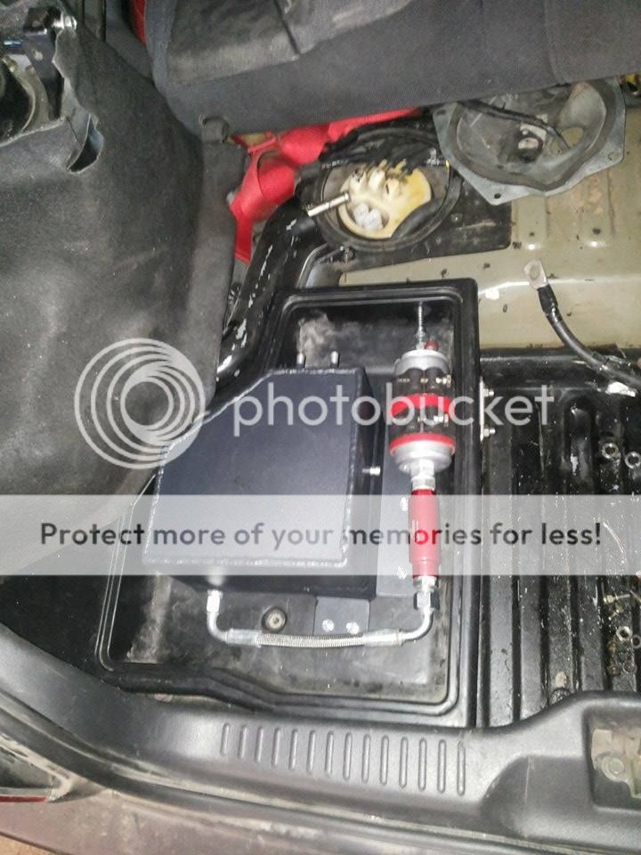

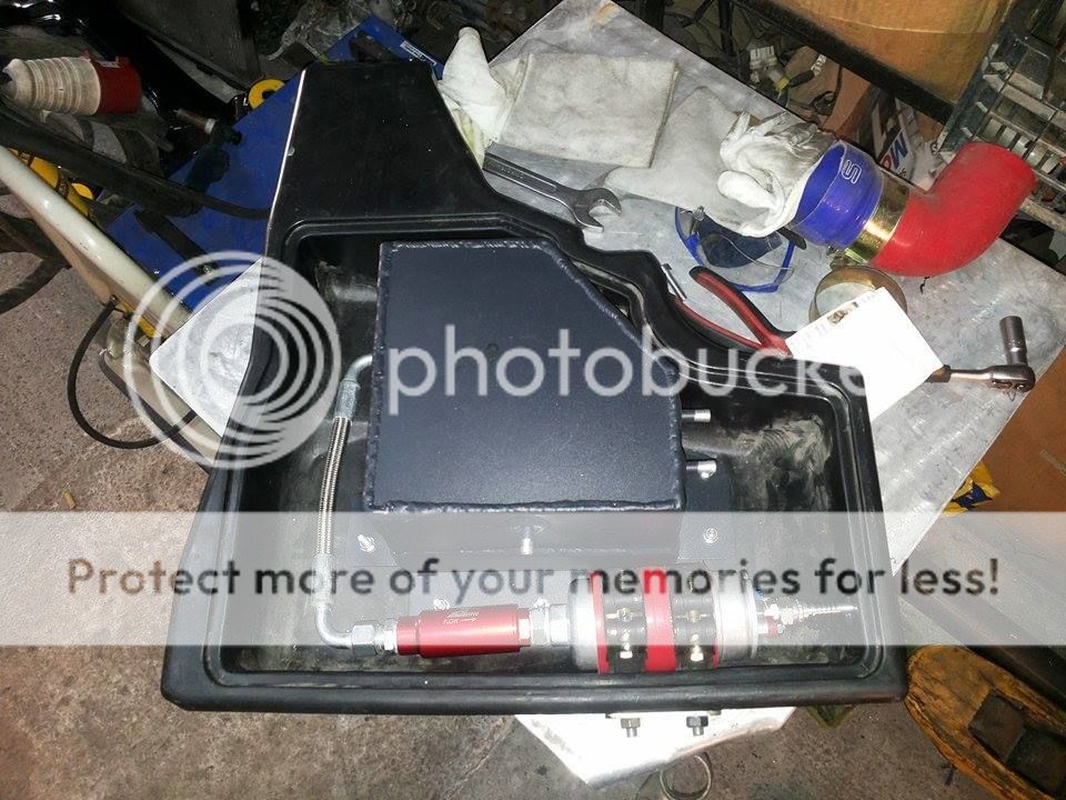

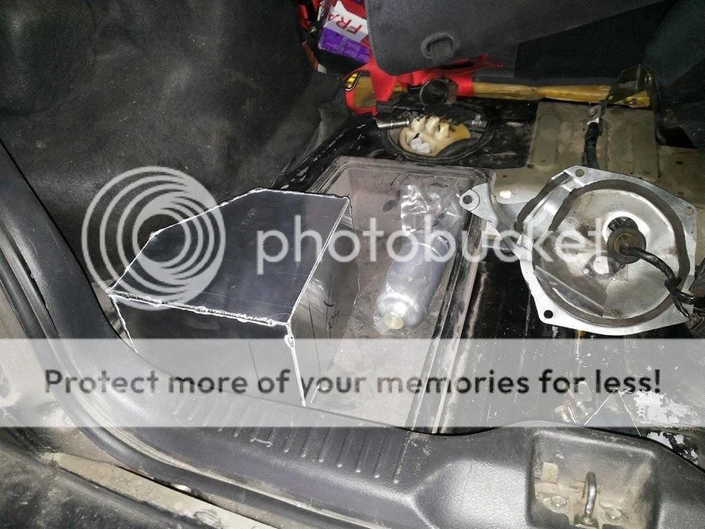

I had a custom swirl pox made up just for the pulsar and a swirl pot and pump sit inside it.
My swirl pit is at the other scotts. Not sure if am going to need it now as am going to try and make a fuel tank and swirl pot in one.

We have the moulds now for making the swirl box for it but dont when we will get to them?
Yes the swirl pot is down with my car. Dont think am going to need it any more.

This is my current swirl pot system:
Two teabag fuel filters, a lenght of chemical resistant pipe and some cable ties.
Fit teabag to pump (tie wrap on) make a small incision in to the pump filter, feed in pipe and cable tie tightly.
Second filter make another incision and push the other end of the pipe intothe filter. Tie wrap up tight as possible.
Hey presto, an intank pick up system and will run without issues untill the fuel light comes on.
Cheap yes, crude, very, does it work, absolutely and cost me next to nothing.
It might not be eveyones idea of a quality idea, but its worked on my track car for 3 years

I'll have a look at pulling it out of the tank next weekend and take some pictures.
Hopefully gives you an idea of what I mean and how I've done it!

I'm not saying the 1/2L fuel filter is a fix. My setup is a full 1L swirl pot and twin pumps, one a lift pump the other a push pump. Best solution, but messy to implement.
The tank is the difficulty. Having a prop up the middle and no balance pipe. So fuel sloshes side to side. My next setup will have the swirl pot under the bonnet, for a whole lot of reasons. More to think about
Jon
That sounds a bit more serious and is what has put me off in the past. thanks for the feedback
I think putting it under the bonnet might be a good solution. - I thought there are issues with having the swirl pot within the car from the MSA; it needs to be enclosed to prevent fires?
Putting it in the engine bay would mean you've got a pump and supply really close to the fuel rail (so always maximum pressure/flow), the engine bay is not within the ca (so no fire risk), and I'd guess you can have a kill switch right there to stop the fuel flowing.

Andy did you ever get pics of this? I'm sure I saw it or something similar somewhere.
