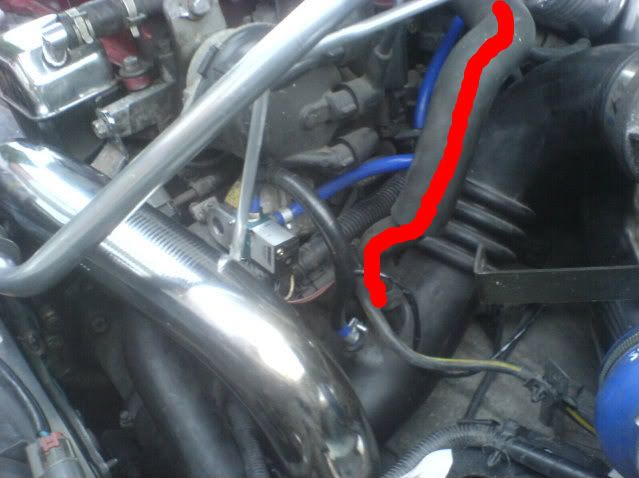

Im getting a hard pipe turbo to filter pipe custom made to match my org type i want to know if there is anyway i can get shut of this breather pipe..
fit a catchcan and run it into there with a breather filter fitted to the other end
warringtonjack
Just out of interest, whats the one right next to it? On mine, I have blanked off the one you highlight, but the smaller one next to it was already blanked off when I got the caR. :noidea:
thats the bleed off pipe from the original boost solenoid
saddler
i have only just fitted my boost controller so im hoping i have done it correct as the have not driven the car yet..
