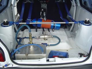

On a safety note (not that I’m a safety nut)
Your harnesses, is that acceptable having them ties to your rear strut brace?
vss irvine
no, it most definately isnt!
if the impact doesnt hurt, the strut brace through the back of the seat will!
i would invest in some eye bolts mate.
noriek2003
agreed,
would be far better off using the standard rear seat belt mounting points, using the strut brace is just plain madness tbh
