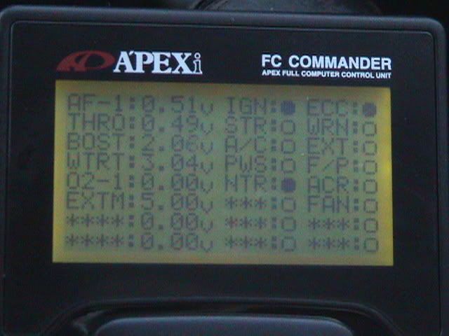

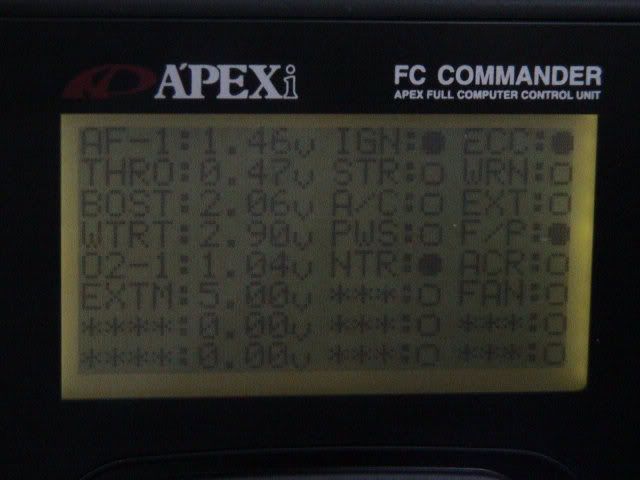

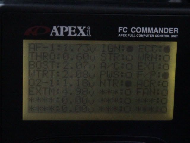

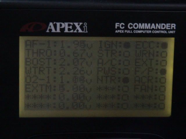

Thanks for that Ross, slowly ticking the question marks off. One thing you could help with is a piccie of your sensor/sw screen at off, idle and at 2500rpm.
Altrnativley I'll check mine tonight too and post up.

Anyway, here is the switch printouts you asked about.
Igntion on -
Idle -
2500 rpm -
3500 rpm -

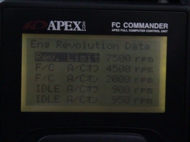

also, here is my revs table, just to be sure -
I have piccies of all the other tables as well if you need them.
Ross.
