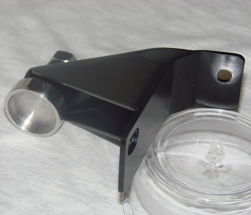

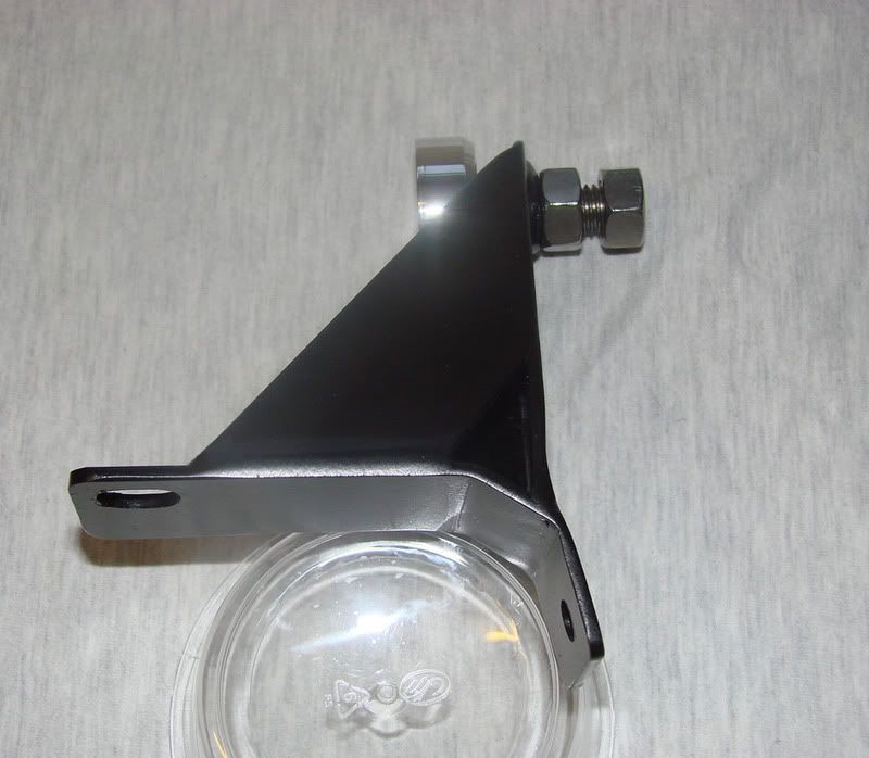

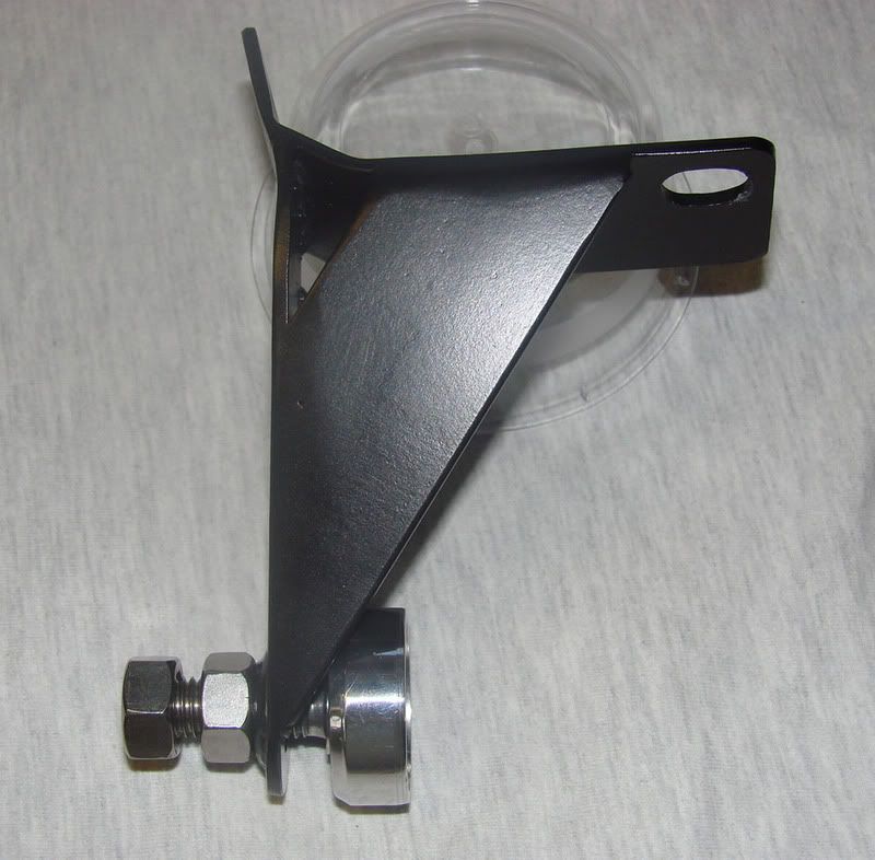

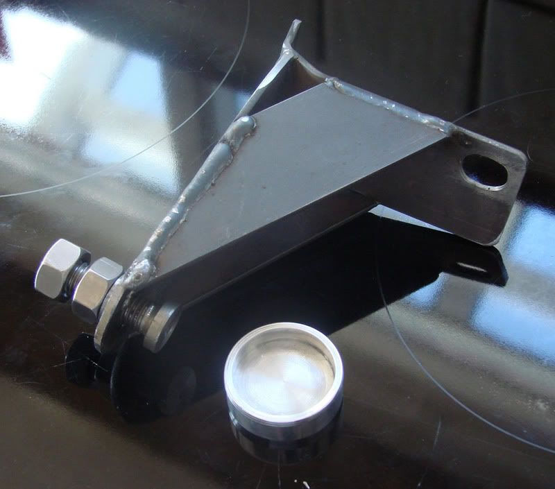

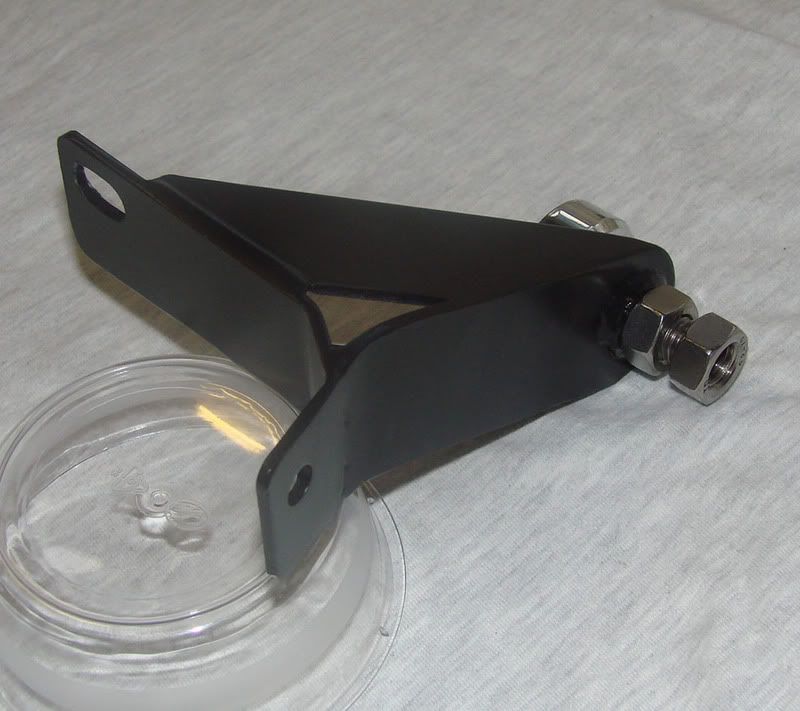

Here are some pic's from the other thread
Please note that the nuts fitted to the adjustable stud to the one in the pic are there for demonstration only. To allow for more adjustment half nuts will be fitted to the finished product.
This pic shows the unfinished/unpainted prototype fitted
This pic shows the Aluminium cylinder cup fitted prior to fitting the bracket.
Showing the completed prototype with the 2 sides of the detachable Alloy cylinder cup.
The main body of the finished bracket is steel, etch primed and sprayed black. The adjustment nut/bolt assembly is turned from A2 Stainless steel and and the detachable cylinder cup is turned from aluminium.
Basic fitting info will be supplied with the kit. Basic tools needed to fit are a 10 - 12 - 19mm open ended spanners.
