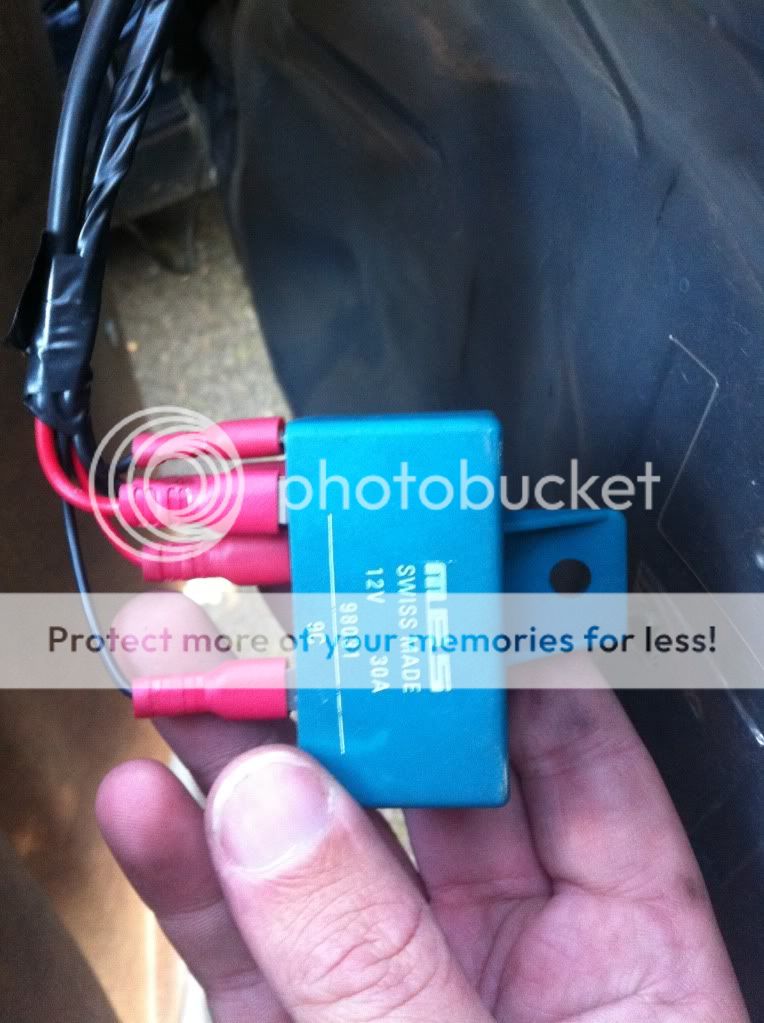

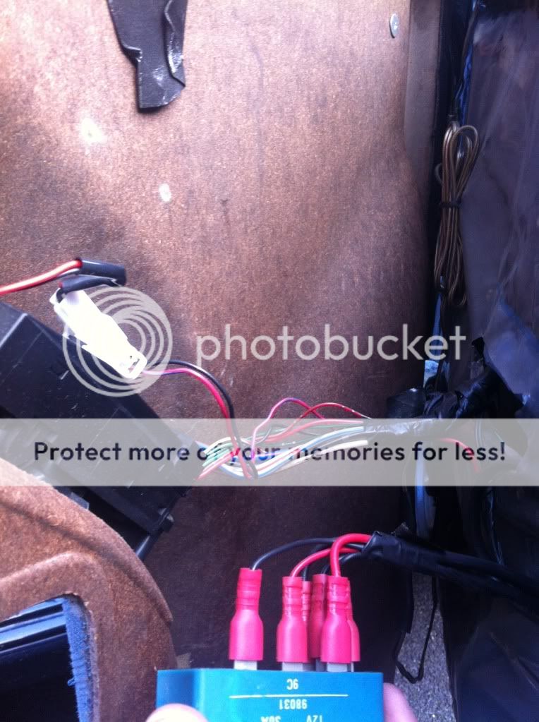

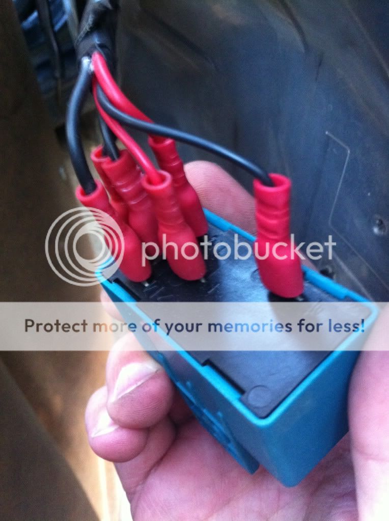

Is this the offending box?
That switch is a central locking relay, would this have any effect on the windows?
I don't think I've got one of those in mine; was it installed with the alarm? I'm pretty sure mine just uses the pulsed feed to activate the locks.
I think that it only effects the windows where it's connected to the switches in the arm rest, so if there's a problem with that it might be sending erratic signals to the locks. - If I'm right about that being a non-standard part, then it could be completely unrelated and it's entirely down to the lock control in the switches...
I don't think I've seen one of those
