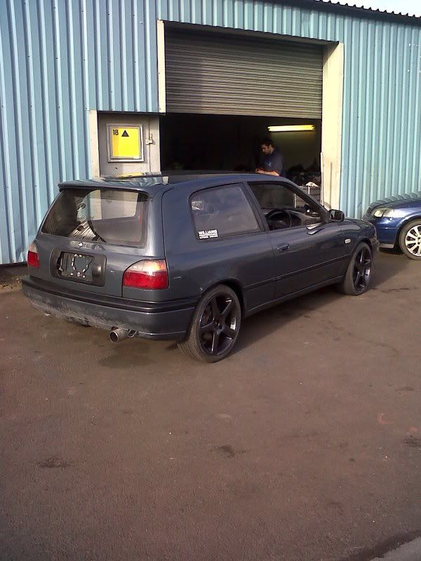

hi williams have you got any pics of your car in the members cars section? as my car was originaly grey but has been sprayed ivory. im thinking of having it resprayed in the original grey but not to keen on grey but yours looks quit nice in your avitar. so just want to have a better look to make my mind up weather to go back grey?

williams
heres a pic after it was painted, looks a bit better since its been cleaned as its covered in dust form the bodyshop there.

looks like youve got another issue there with the high idle mate, always a nice fault to get sorted. Cars looking great considering it all came in bits lol. keep up the good work!
