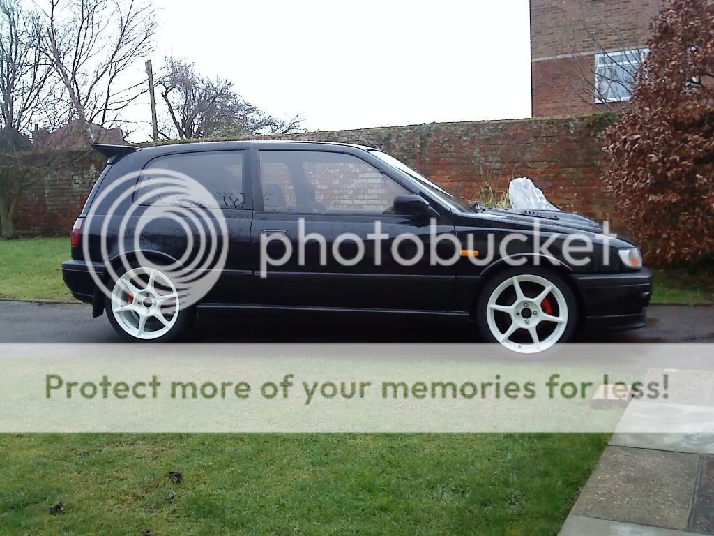

my pulsar had tannbe front shocks,standard rear and a unknown set of springs.
It sat like this fronts were very rock hard!

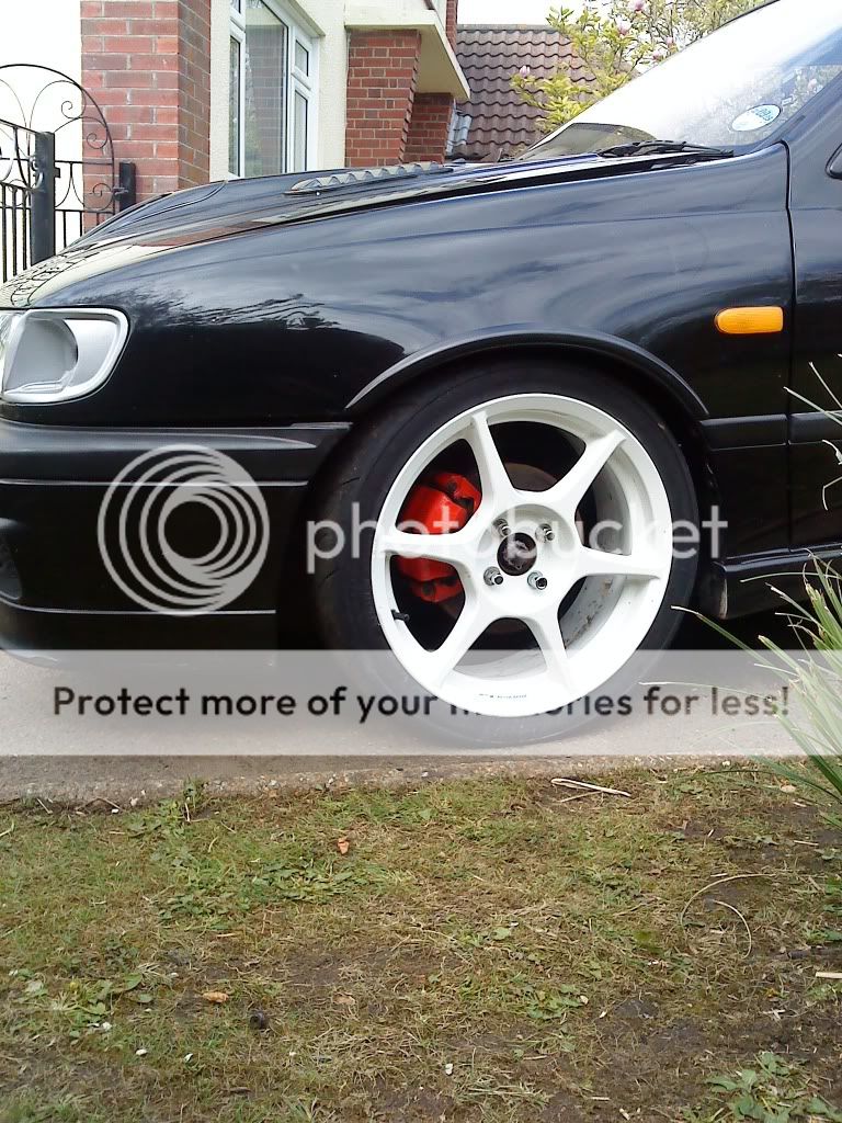

I fitted the front and was happy how it sat up front,

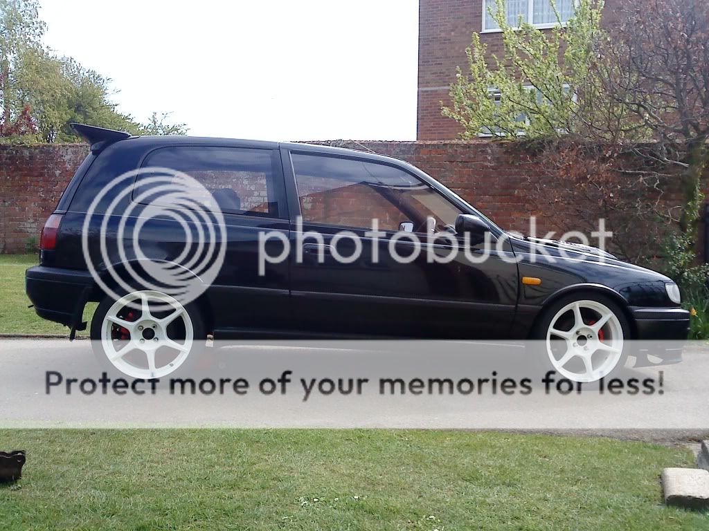

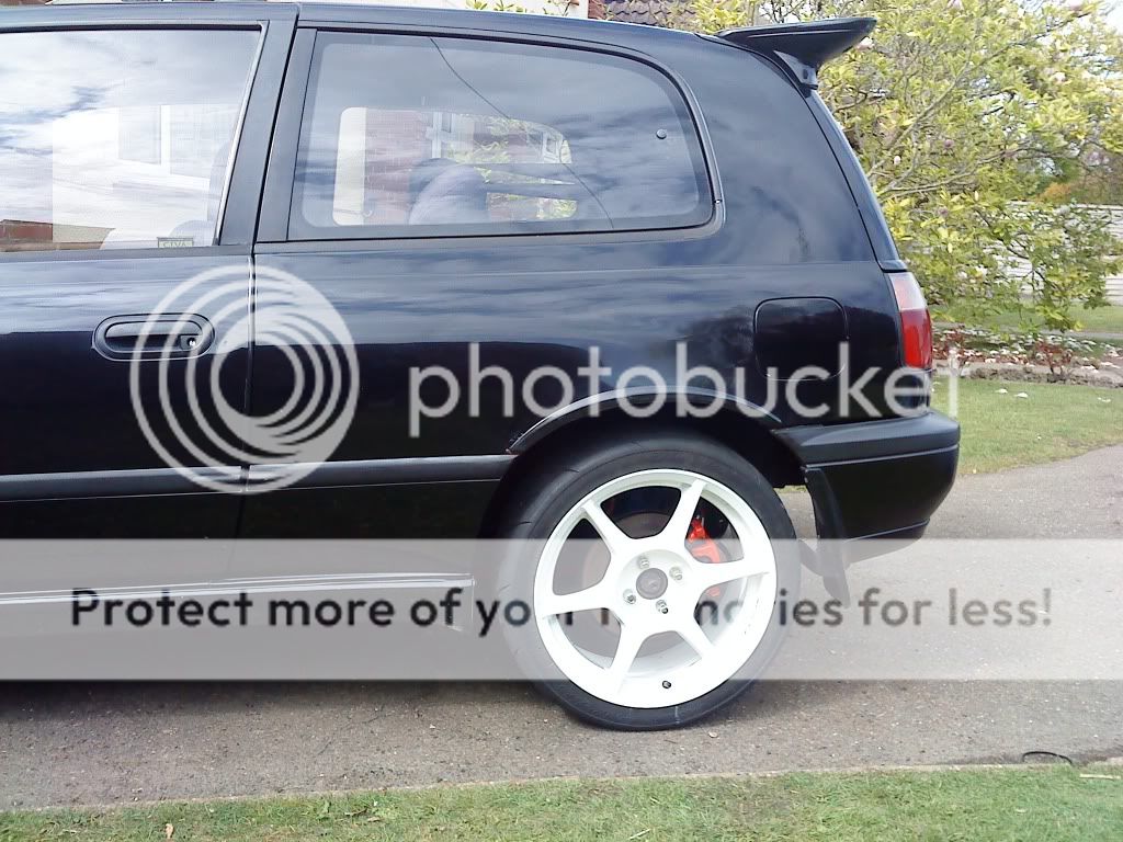

Now to the rears it wasnt sitting to bad,so took the standard shocks off and fitted the rear kybs with very short springs the ones it came with but the rear sat about 2inchs higher than the set i took off.I thought strange there at least 2inchs shorter hows this happened, so thought oh'well take them off and fit the old springs to the kyb shocks all ok did everything back up and dropped the jack to find this!!!!!
:faint:
How the hell has this happend what have i done wrong?

i really cant see how this has happend the shocks arnt any longer than the oem ones and if ive fitted the same springs how can it lift it that much higher,

the reason why is that those springs pictured have been cut down considerably to lower the car, are they the ones fitted now or the larger set?
also the front looks like its sitting too low which will exagerate the rear height.

Yeah i gathered that bob they had been hacked at, but the springs that are on the car in the pic sitting higher are the same as the very top picture. So what would make using the same springs and top cups but just changing the rear standard shocks to the kyb that are the same lenght iam pretty shore on make it sit that high, even with those very short springs it sat higher than before,
well if the rear dampers were leaking you would have no resistance in the strut so the cars weight would be merely riding on spring tension but now youve fitted new dampers this could take the weight off the springs so they are not compressed as much

And sitting on the rear now is the 1st pic (before) springs and cups, with the after set of shocks, once my exhaust arrives this week ill fit it then take it for a drive,
The fronts are the new shocks+sprongs and cups.
