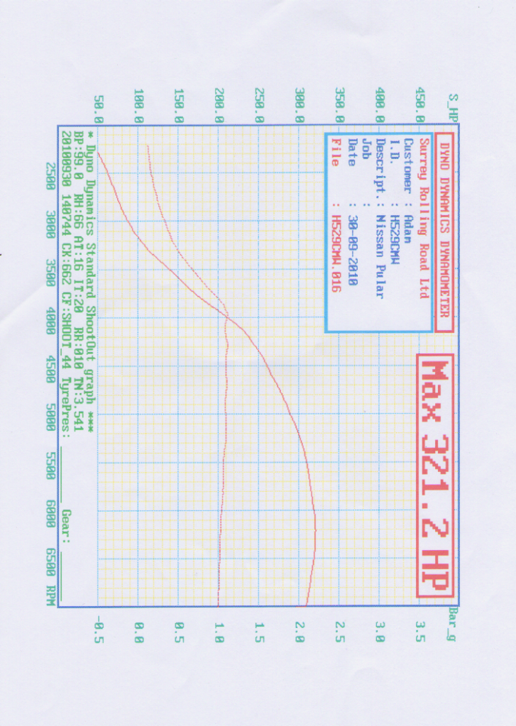

Had a nice clean pulsar in today. Usual mods FMIC fuel pump and Sard pressure reg. With a mongoose exhaust but stock elbow the care was in every other respect stock clean and tidy. Fitted nistune on it and went on the dyno. I was driving/running the dyno today (but charlie @ srr set it up as usual) as the owner (Adam) is a bit keen and wanted to have a go at mapping and had done the EFI course etc but no practical experience so I guided him, told him what to do when and why etc and we mapped the car.

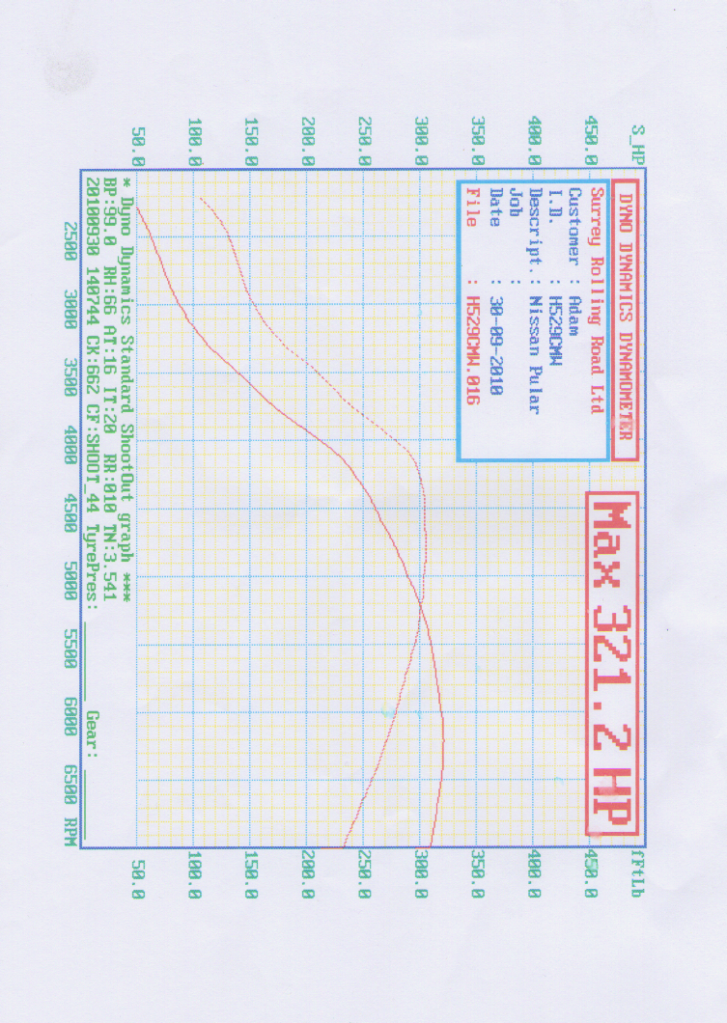

I don't have the graphs with me now but the car made 321 hp @ just over one bar at the top end with 1.1 bar at around max torque (cant remember exact figure around 300lb i think) ill post graphs when i get them sent to me.
Either way it may now be one of the highest stock powered pulsars I've ever had, and the reason I post it here is if we were running 1.2 bar on a stock setup like many do blindly here the car could have potentially been in trouble, as I have now seen the power vary by 40hp @ this boost depending the car on test. Some go massively lean, on this we could up base pressure to 3.5 bar so effectively making the injectors the same as 510ish cc, but the AFM was on its limits thats for sure. Also interestingly it was very sensitive to ignition. It didn't knock (you have to be way passed minimum best timing for that to happen) but just one degree retarded from MBT lost 10hp. All in all a great result and now a really nice car do drive.
But as a said and please don't just take my word for it, If you do follow advice of others and just blindly set 1.2 bar do get your car checked just to make sure its all happy and safe etc.
anyway ill get the pics up sooner and show how it went.

I know its lame and people will read this and say of course Ill say it, but such huge gains can be had from a proper remap. This car today started at 260hp @ 0.8 bar at peak power and left with 320 odd @ 1 bar at peak power. 60hp doesn't come from just 0.2 bar alone so we did very well in this case. Most pulsars will get around 300-310 at this boost I find, but some just work better than others. We gained 6hp alone from pulling out fuel at the top end as the nissan (and others like mines for example) runs so rich at the top end that power is just lost.

Yes chuffed to bits with yesterdays session, basic tweaking of maps on the road is one thing, but getting to grips with full dyno feedback is another, so thanks Ed, great result and advice as always.. hatsoff sir.
I must admit, the stock Nissan timing is a mess, really undulating and i can't fathom why it would be set in such a way; it's possible that the japanese image is calculated this way due to climate and octane, but nevertheless it made the 3 dimensional landscape look like the surrey downs. Glad to have this ironed out and a smoother delivery because of it.
I also can't believe the power that it made, my STI5 which was a whole 8 years newer than this car (and arguably at an advantage due to engine layout/drivetrain) made identical power on a VF28, 440 inj, walbro and 3inch exhaust, quite remarkable really.
