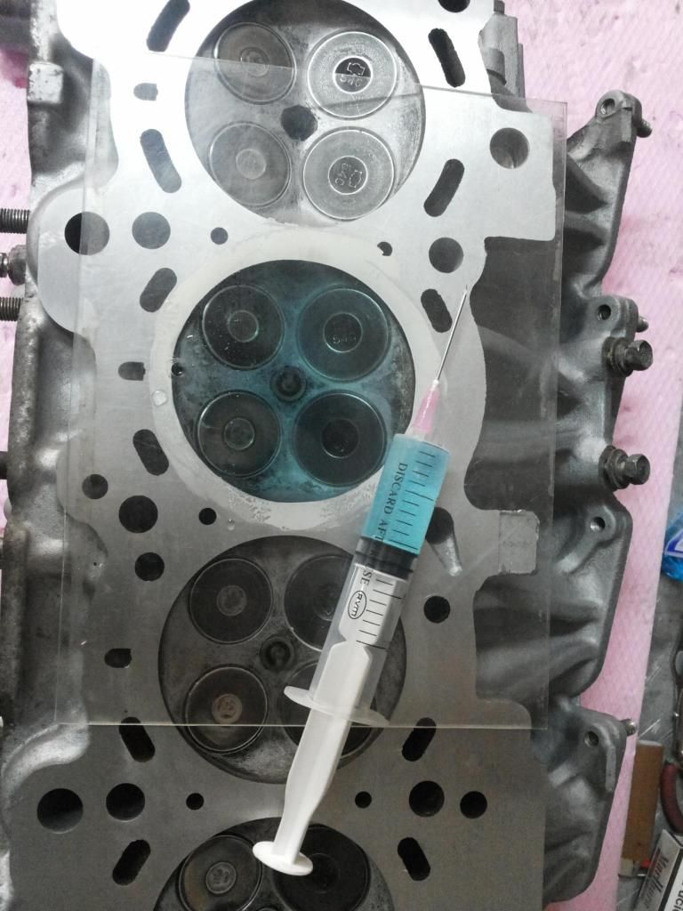

So.....I have went to a machinist which repairs cylinder heads.

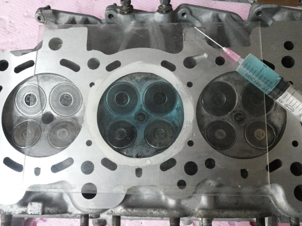

After that I have made this test.........to find out what my cyl. head volume is and the results were 50 cc's.
Enlarge this image
Enlarge this image
That's kinda sad because the standard head volume is either 46.1 cc's (according to SR20 forums) either 46.5 cc's
I have used 3 comp. ratio calculators and all came up with the same results.....7.95 to 1 comp. ratio.
This is too low.........low low!

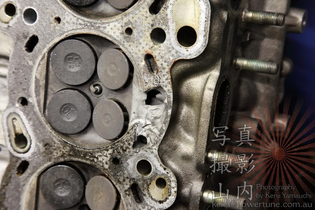

Just for the info ...this is an 200 SX head.

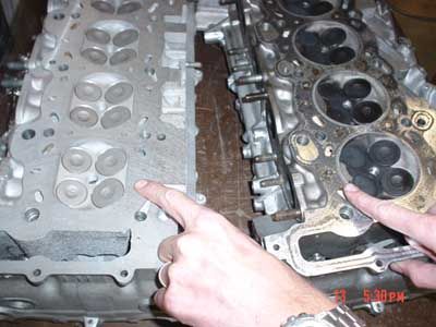

This is the comparison between the two....right is Gtir and left is 200 sx
And this is the Gtir Head......
.........In which everybody can clearly see that the reason for the lower comp ratio on the Gtir head

There is 2 types of 200sx heads, one has quench pads on the inlet and exhaust side and the other has them on just the inlet, quench pads will give better burn in lower powered sr20 and therefor better emissions, but will ultimately restrict how much power you can make...hence why on the sr (inc vvl turbo)and RB engines people machine out the combustion chamber to the hemispherical shape like the gtir..like mazworks .
