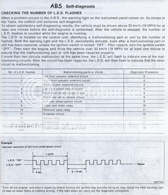

the ones that bolt into the hub/driveshaft?
:shock: :shock:
D
DodgeT
5 flashes
as suspected, front left sensor
looks like he'll be paying for one for me.
cheers for the info :D
