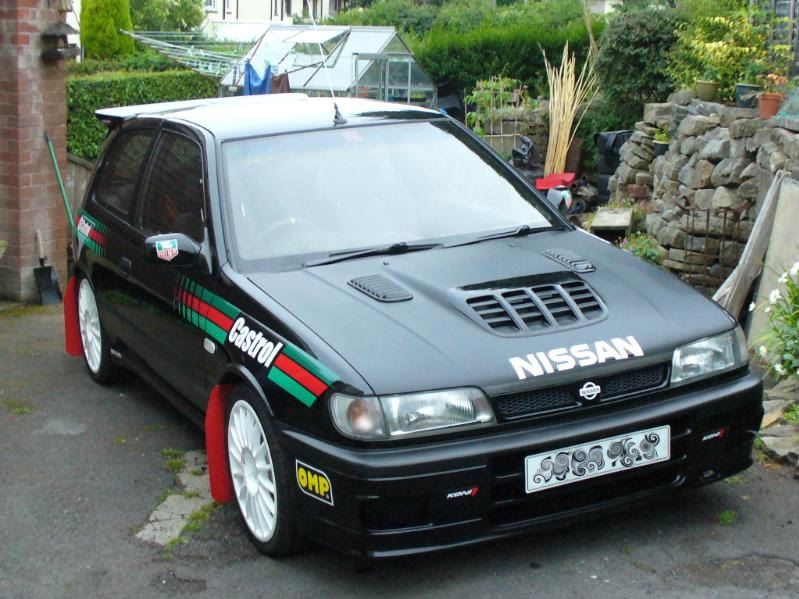

Not been on here for yonks but just recently decided to get my finger out and get the R on the road.Just been to the garage for a can of petrol to top it up.Started the car and its very spluttery,popping and burbling with the faintest of touches on the gas pedal? Almost sounds like a car on launch control? Swear i heard a faint ping and the engine check light is on? I have disconnected the battery hoping for the fault maybe to reset? GRRRRRRRRRRR I was hoping to mot it next week! any ideas or thoughts? cheers

Right the dipstick that i am forgot to say it has an APEXI AFC2 on it. This 100% needs setting up as the world and is dog have messed round with it before i bought the car. I have switched off the G Reddy boost control unit i think. The pamphlet i have for the Apexi is only readable if you are a rocket scientist????? Is there a way of switching the Apexi off and the car running standard? cheers. If i can get it running smooth again i will put some updated pics of the rally slag on! Just to add the car isnt being driven but has been started every week and runs sweet as a nut but just went rough the other day?
