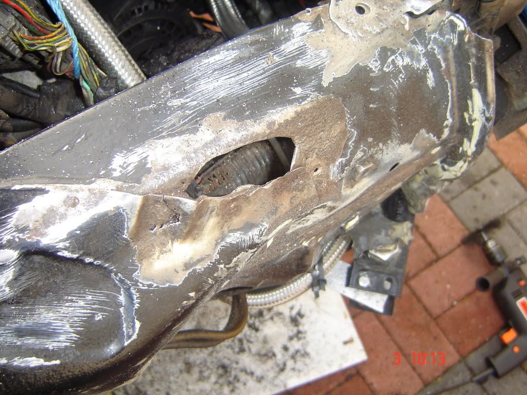

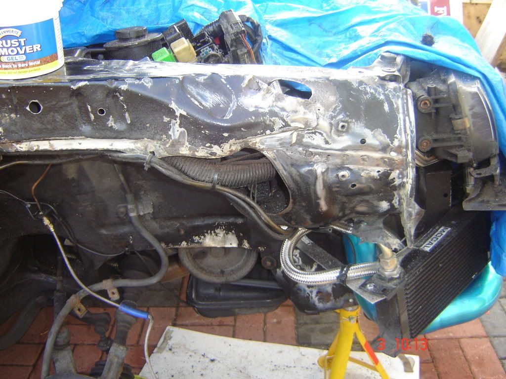

as my turbo blew up last week i decided to take it off the road, and do little bits and bobs on the car to make it better, untill i can get turbo etc

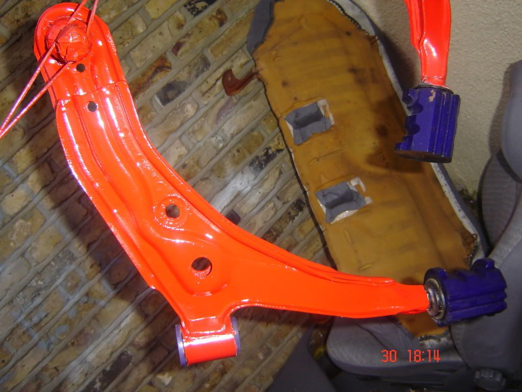

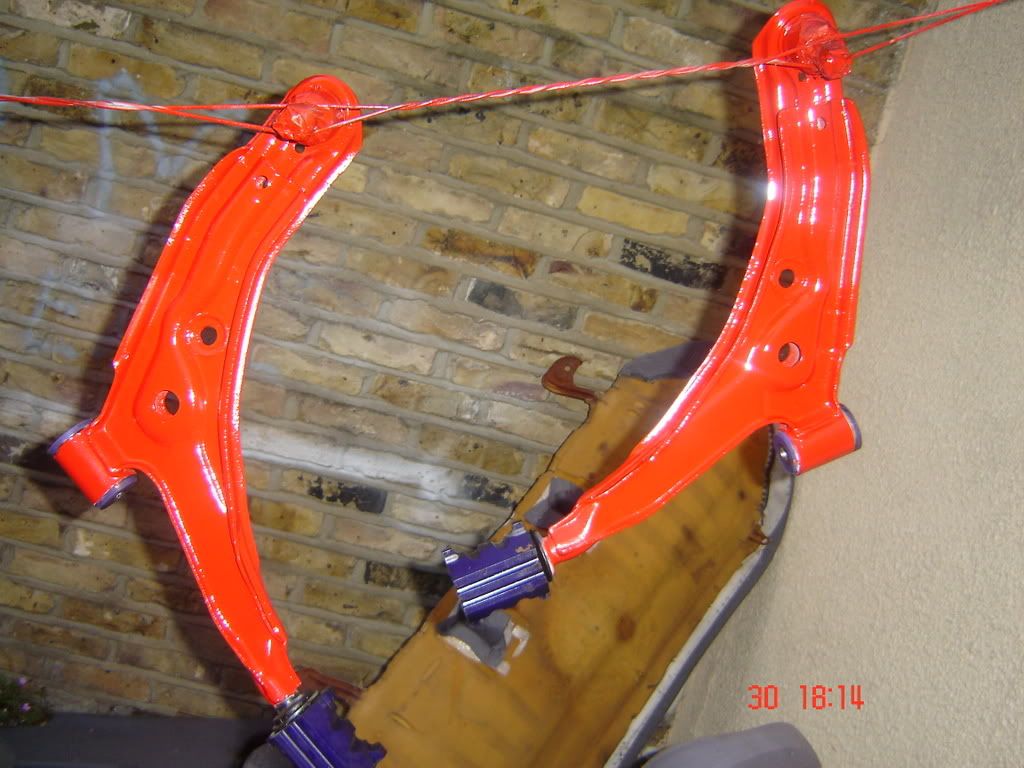

1st of i removed wishbones and refurbished them, wire brushed them to bear metal, replaced all bushes and ball joint, then primer and painted with hammerite red:-D

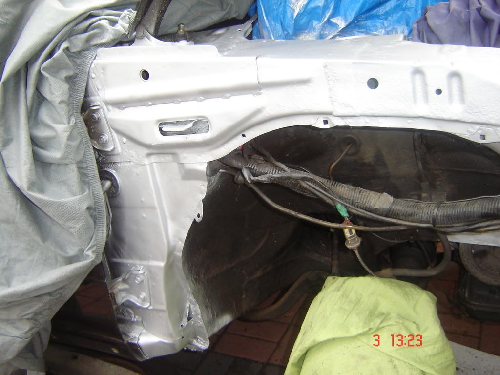

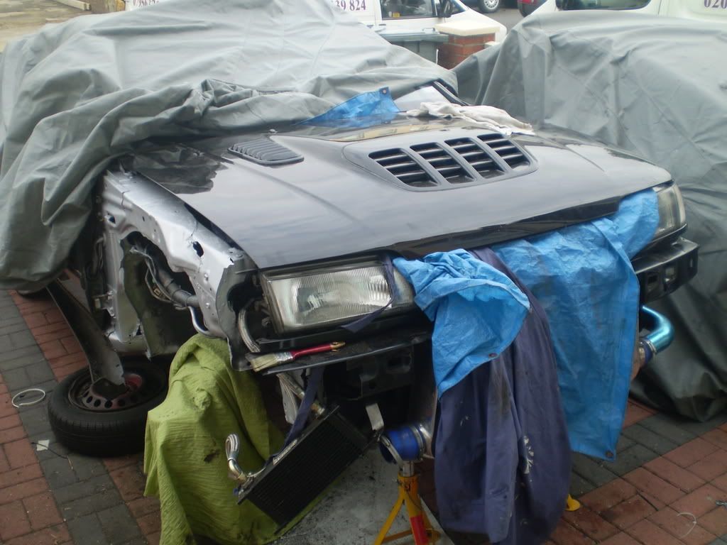

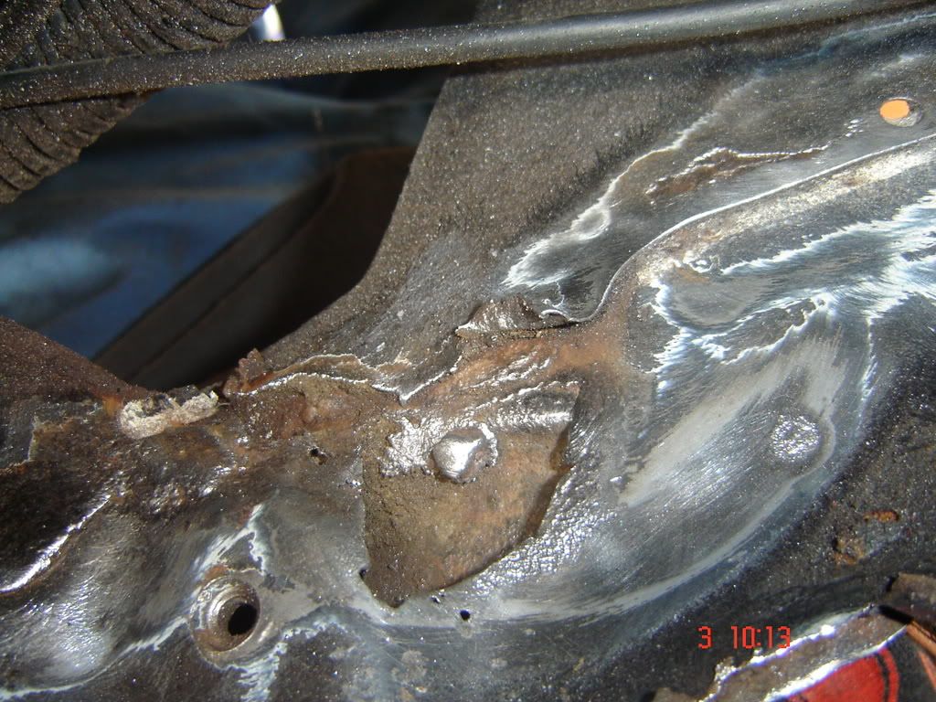

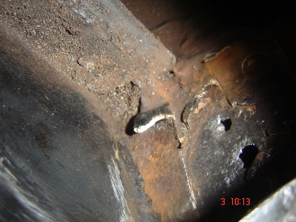

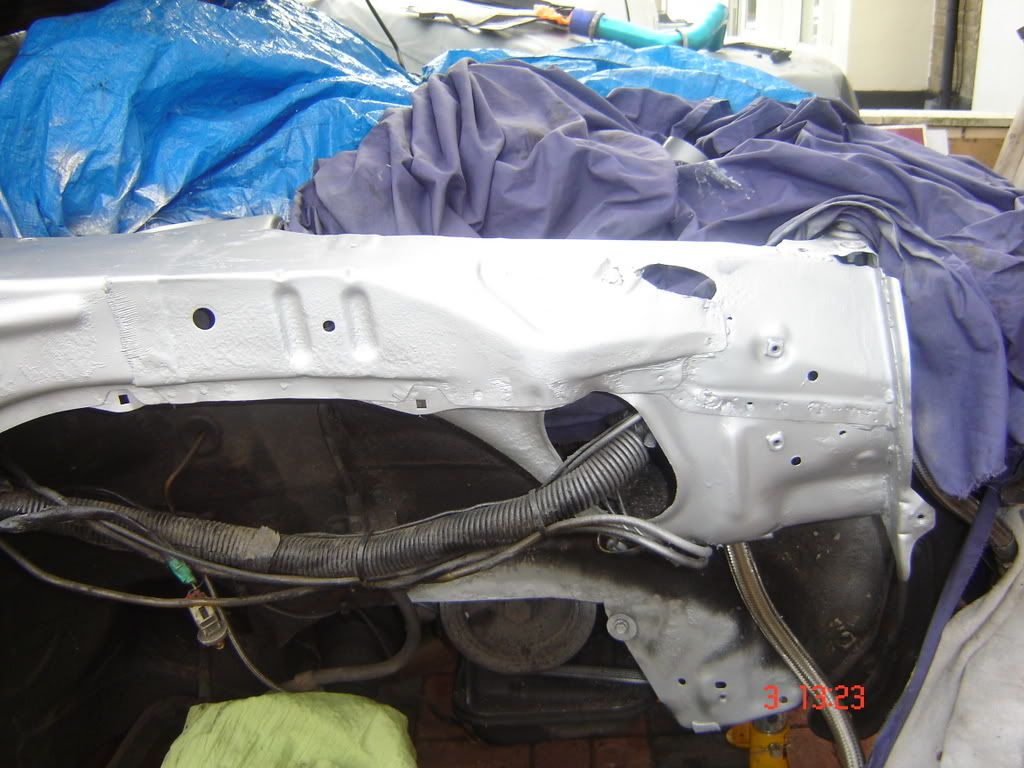

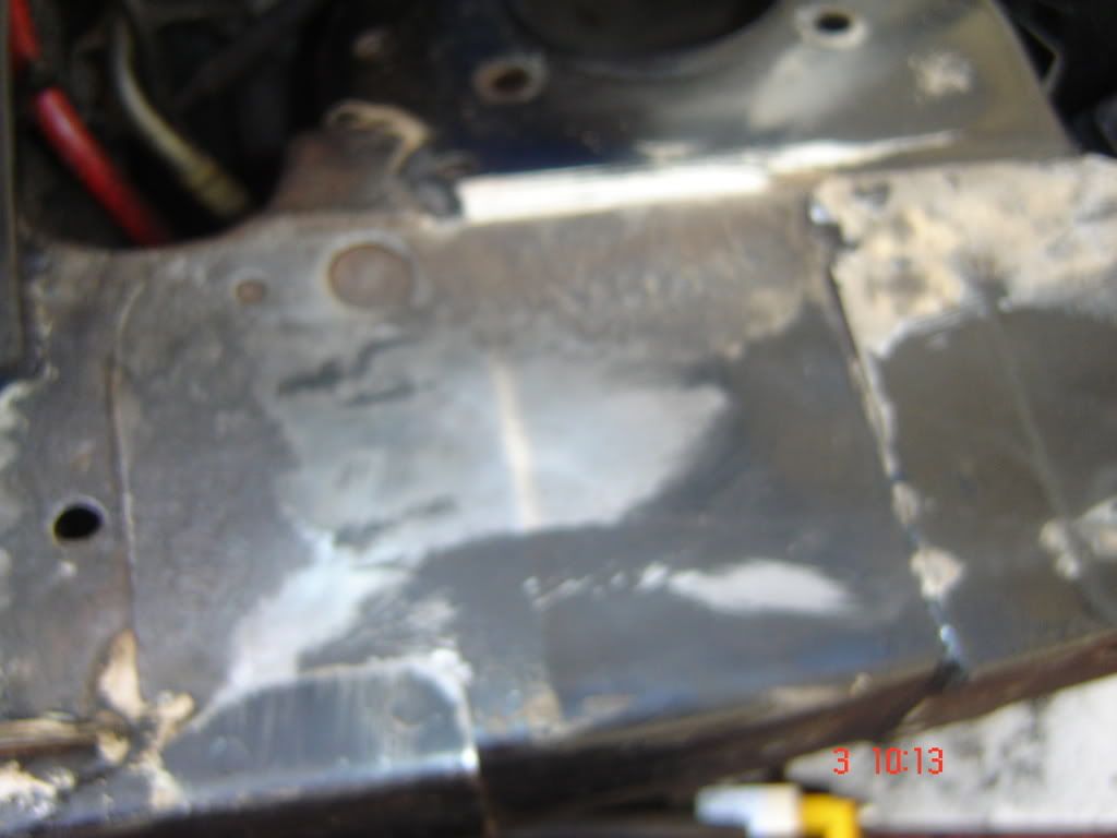

then removed the wing to get rid of some rust, then primed it with zinc rich primer, still need to weld the holes, still got the other side to do:shock:
need to paint over primer once holes are welded over... also need to seem seal aswell once dry
this is how it looks now lol:-D
once other side is done then will waxoil as much of the car as possible.
