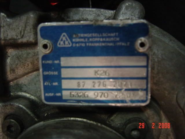

If you can, get some pictures, i'd quite fancy having a look.
Adam L
Have you got a photobucket account?
Just upload the picture into your album, then copy the html link underneath the picture, then paste it into your post and it will appear as the picture.
Sorry, it's not the html code, it's the IMG code.
Adam L
IF you use the IMG code underneath the picture will appear in the post. The second one works anyway, so no worries.
It looks similar to a T3 core but all the fitting are different, the manifold too, although you could see if it would fit a T3 flange.
It's definatley an old skool KKK turbo, I think the group b spec ran larger housings, the wheels may vary too. It'll still be good for a large amount of power, how much, I don't know.
Adam L
Ah, the part number tag. Is that 7230 at the end?
For a laugh, I can find out how much these cost new and if they're still available on Monday.
