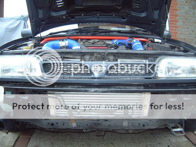

:D Hi again,Just completed fitting my RADTEC frontmount intercooler and race spec radiator :!: Took me 2 hours approx to get everything in,but had a niggly problem the boost hoses from the turbo which took another couple of hours.But popped up to see Keith at RADTEC and he's got it sorted :!: Piece of cake to bleed the rad,water temp and oil temp are as normal.Best thing is boost has improved slightly :!: And for all of you that fitted a frontmount and didnt notice a difference straight away,You've got the WRONG one :!: Mine saw a difference throughout the rev range and third gear was totally different,where as before fitting it,it seemed to back off in third,now it just wants to pull :!: :!: :!: And NO LAG :D :D :D after sitting in traffic :!: I'm well pleased with it :!: :!:

:D Yes mate,all the aircon is still in place :!: All you have to do to fit it is remove your old top mount intercooler and original radiator,then it fits in the radiator mounts :!: :!:

One thing i hate about that kit is the way they use the standard turbo outlet pipe, just looks horrible :(
Still, if it works it works 8)

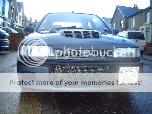

:D Cheers for posting the pics Mart :!: No mate no pics of the front of the car because you can't see the intercooler from the front as i have retained the aircon radiator which sits in front of the intercooler :!:
Thanks again Mart :!:

Do u have a pic with the bumper on? Very stealth!

i will take a pic of the front when its light outside :wink:
