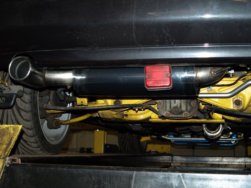

You mean like this > ;-)
I had this full 3" system made by AAS in Newcastle, I had it designed with two proper boxes, One like the goose cat replacement box and this big back box exiting out the passenger side, It's defo a lot less boomy and quieter over all.

That's him Rob, and very nice too. I'd forgotten you had something similar !
Of course the tail pipe size plays a massive part in sound level and quality too. If you have a 3" system, stay with a 3" tail pipe. Any bigger and it'll have a 'megaphone' effect on the exhaust sound.
Paul
