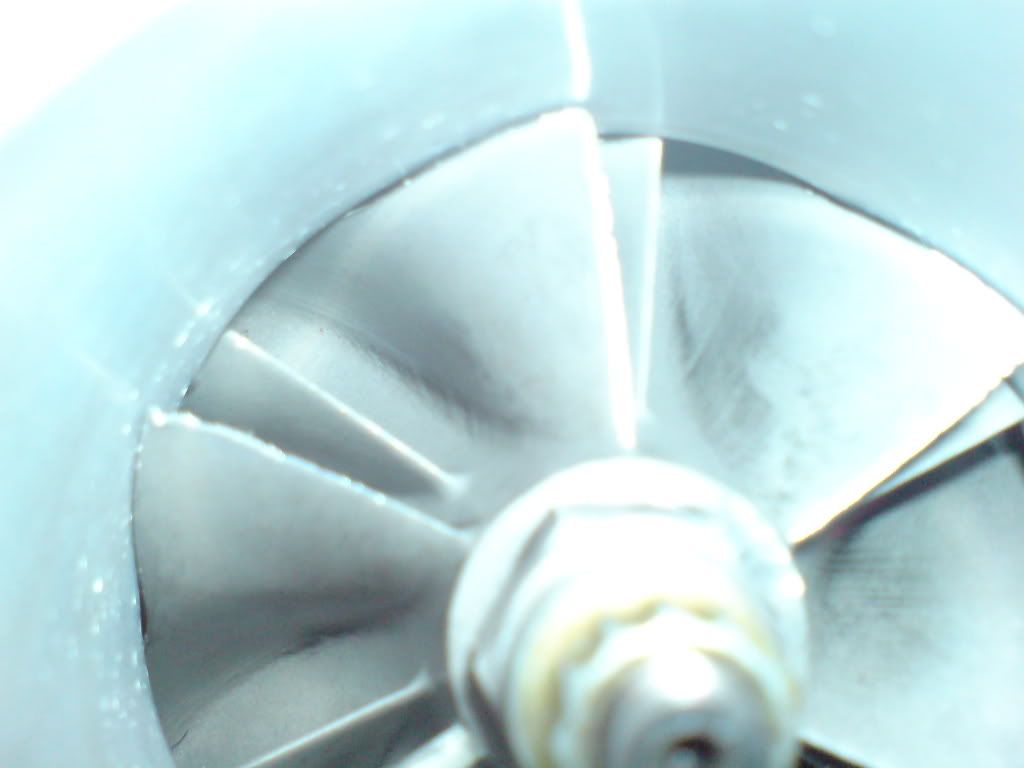

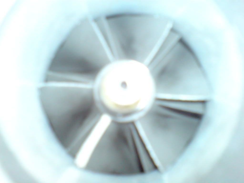

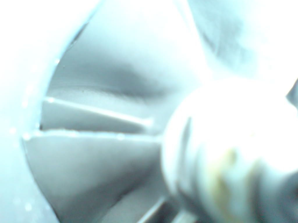

Bought this of a member on here on the understanding that there were a couple of small chips on the blades on the comp wheel. Showing it to a few people they have all come to the conclusion that it is fookerd.
Have i just wasted £350 or is this fixable, the rest of the tubby is ok and there is virtually no play in the shaft.
If there's no play in the shaft then it's fixable.
You could use it as it is. It might whistle, not produce full boost or it may work ok. It will be out of balance tho, so it might reduce the lifespan.
I can only realy make out anything on the bottom picture, some in focus pirctures may give a better idea.
gtirneil
Theres very slight play in the shaft, not even 1/2mm, the lad said it boosts to 1.5 bar and was fine.
Can the wheel be changed or is it better to buy a new turbo, i dont want to be taking risks as its going on a freshly built engine.
Sorry about the pics, camera phone quality for you.
gtirjoey
is it a 3071r as my new one in a box has very minimal play and every 3071 i have ever seen has! assume its a 3071 from your signiture
gtirjoey
when it that cause dont worry about a bit of play. As for the blades i could not tell you as the others say just fit it and see it will not damage your new engine if it does not work properley. Jus waste of a few hours fitting a new one.
if it were me i would fit it just to see, if it works you got a result.

Small damage like that is normal on turbos after being in use for a while. The air filter hasn't been doing the best of jobs. You're unlikely to have the blades break off and go through the engine, unless something biggish goes through the turbo.

if it was a std journal bearing turbo i would have replaced the compresor wheel,balanced and it should have been like new.
but it is a ball bearing turbo so I believe that the wheel cannot be replaced and you need to buy a new center section.
At least this is what i have heard on GT turbos.
For sure it will not perform as it should and it will be out of balance.
Would not fit on my engine...better to be safe than sorry ...

its damaged as you can see but i doubt whether itll effect performance that much tbh. and at £350 i would say its a good price! slap it on and try it, as karl said its just a poor airfilter (probably hks mushroom) thats allowed debris to hit the blades
