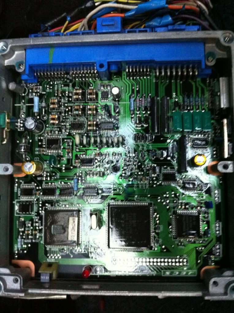

is this standard or aftermarket ecu?

Looks like the upgrade has never been fitted to that ecu.there must be a socket soldered inside the ecu but its not there.the seller has prolly swapped the full ecu, or has sold the daughterboard without fitting it.
Map on the gizzmo is a tweaked mines map,had very good results with them
