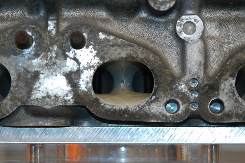

I forget the exact figures but the ex flows something like 66% of the inlet, you want to get this to approx 80% and that will come from working on the exhaust valve pocket. The inlet pocket also improves with work.
This was just an experiment to see how much smaller the ex port could be without dropping ANY CFM.... putty was added to the bottom of the port
The same was done with the inlet and a similar amount of putty could be added to that port, so it shows that the ports themselves are massive.

The head flows shite compared to the theortical amount for the valve sizes LOL especially the exhaust!!! (compared to a skyline head the GTiR head flows great LOLz)
The pocket is the area around the seat to where it then opens out into the port (so approx from the seat to 90 degrees to the seat.)
That area and getting the seats done well is where you want to be spending money.
The ports can be shaped slightly differently in certain areas but the gains aren't worth it for the amount of time involved (they are pretty minimal)
