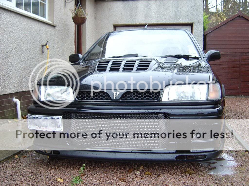

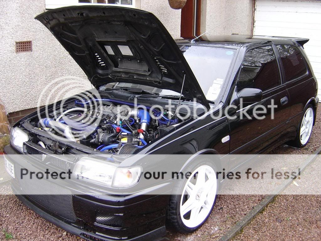

Rishi,
That looks unreal! I think that's one of the neatest cut out front bars I've seen. Blue rocker cover looks tops too!
Tim
