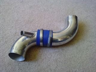

Make one, you'll need 2x3" silicon joiner, 2x45 degree mandrel bent pipe, and then one 3" silicone reducer for the inlet, depending on which size inlet you have(I have 71mm)or if you have the 3" inlet then an extra 3" silicone joiner rather than a reducer.You can save money by buying a longer 3" silicone length and cutting it to suit.Get 2 jubilee clips/mikalor clamps per length of silicine and job done.

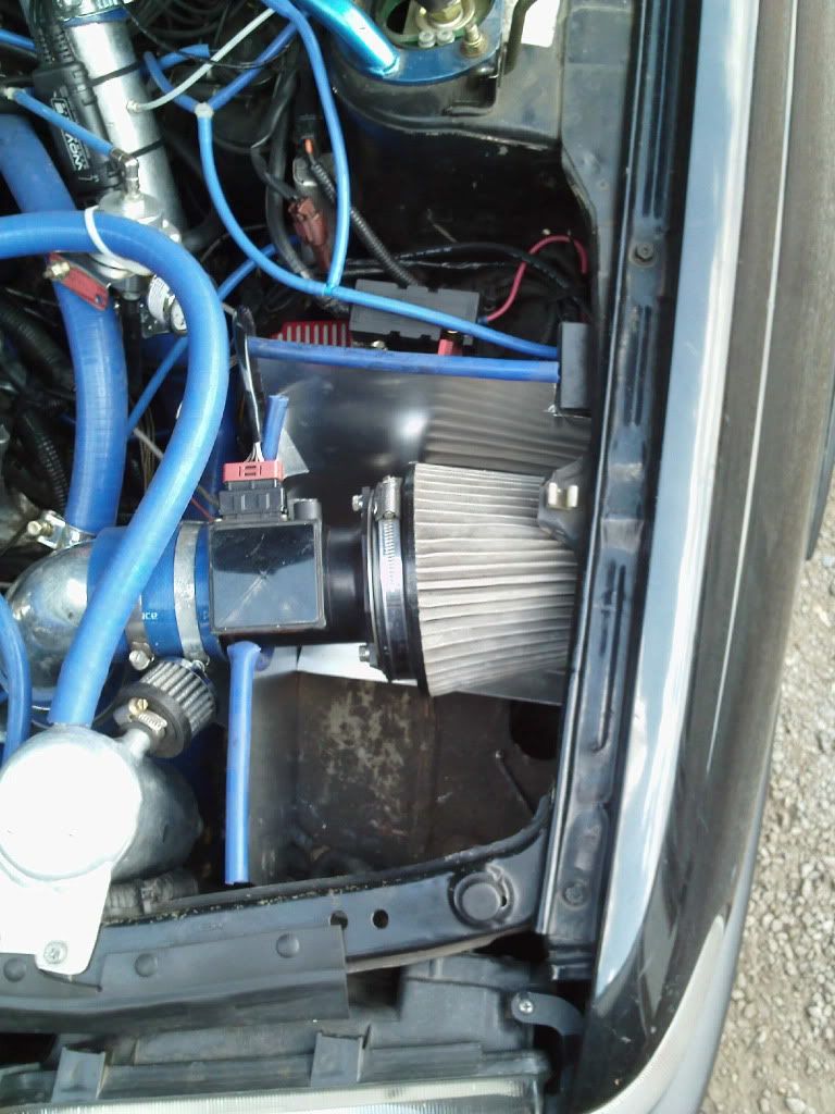

I bought one that put the filter in standard place then modified it to sit it behind the headlight and had a pipe welded on to recirc my dump valve(its missing the silicone joiners to MAF an dinlet in this pic).
