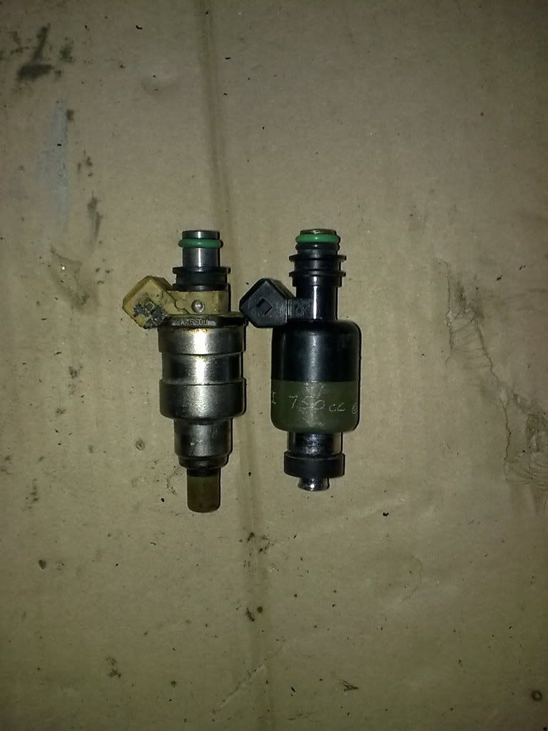

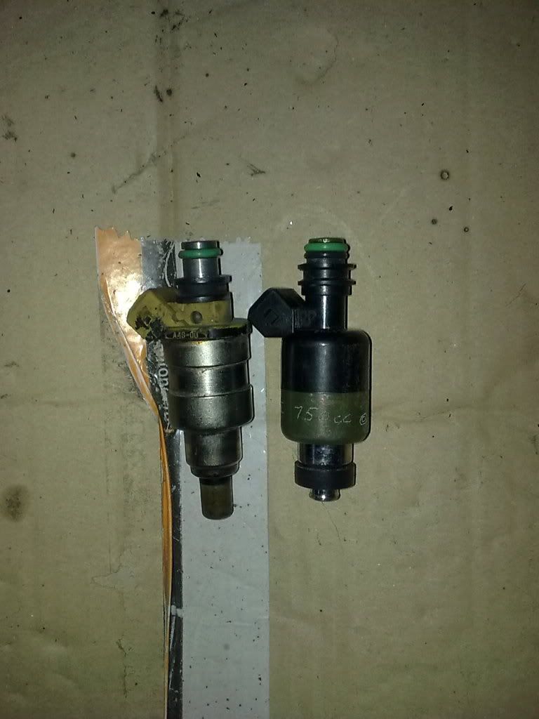

I just bought a set of 750 cc's from the U.S.A. and it seems that they are shorter then the standard ones.
Please give some advice guys because I have had allready enough with this piece of just (that it's called car)
Can I use them as they are???
Like dave says, they look like they'll fit ok ish but the fact the business end of the injector wont be protruding into the inlet as the standard injectors does might cause you some fuel projection problems.
Personally i wouldn't use them, I'd look for some others that we know work as they should.

It seems that they are Delphi 17113742 and they rated at 75 lb/hr.
They look like they are used ....but I went to some guys who clean injectors and they told me that there is nothing to clean at them because they flow perfect all 4 of them.
They couldn't tell me about the capacity of them but according to Delphi specs they are 750 cc's.
Any more ideas will be perfect.
