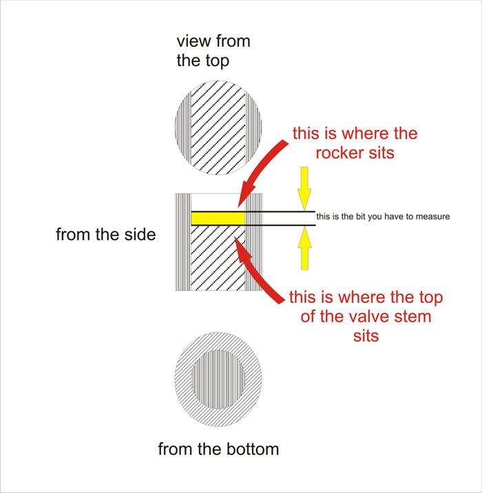

Ok the whole guide is 8 millimeters tall, it is 5 millimeters to the bottom of the guide and the dimple where it sits on the valve is 3 millimeters deep. If I need to measure anything else just let me know thank you.
It's a little more presice than that I'm affraid. Give me a moment and I'll draw you a diagram.
Steve
The image in the centre is a section of the guide looking from the side, the section in yellow sits between the top of the valve stem and the rocker, this is the measurement we need. If your on a base at the moment you need to take the guide to the engineer on base and get him to make the measurment with a vernier to get the exact size.

i can measure it with a micrometer but we only have inchs so i am gonna go to metals tech and see if they will measure it for me in metric
OZ-Racing
You could always convert it ;-)
1 inch = 25.4mm
