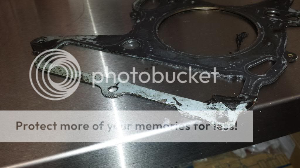

2 failed attempts at putting up a picture and a photobucket account later you can now see my old head gasket. can any one guess what happened to it?
jaygtir
He that shall not be mentioned for fear of upsetting the moderators and breaking the forum rules ( except were he is named in post #1 ) tried to remove and refit the oil pump in situ to fix a front crank oil seal leak on an engine that had done just 10 miles on a fresh forged build. when the oil pump would not clear the compressed head gasket to go back on out came the dremal and 1 layer of the multi layer gasket was cut out and replaced with instant gasket paste.
That there my friend is not only the luckiest guess i have ever seen but smack on the money.

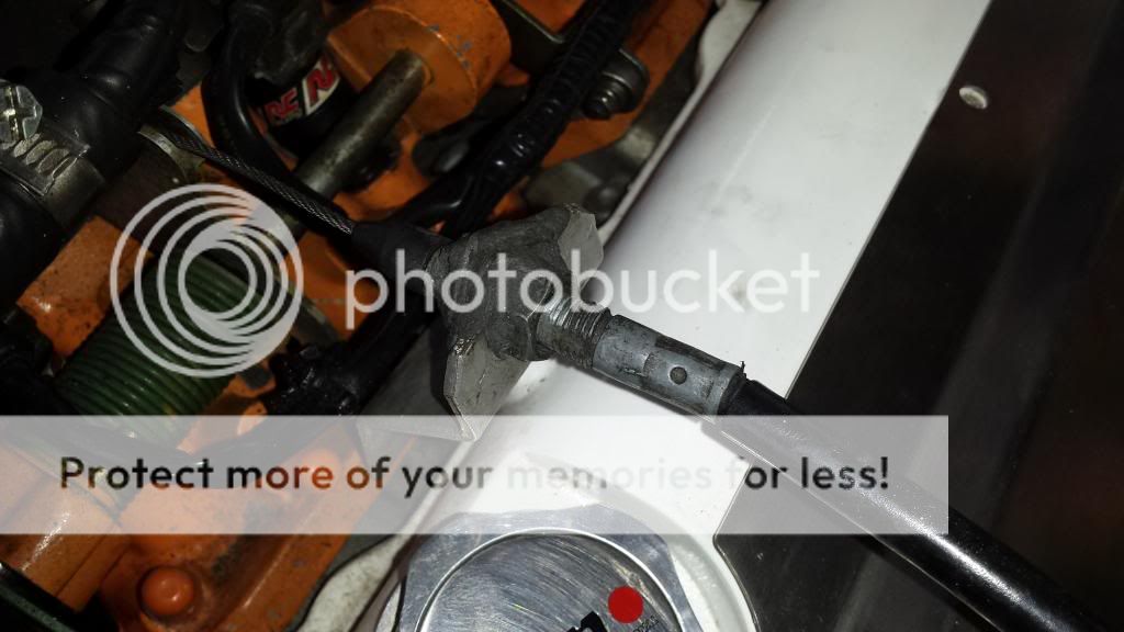

Throttle cable held in place with perry paste because some one has striped the thread.

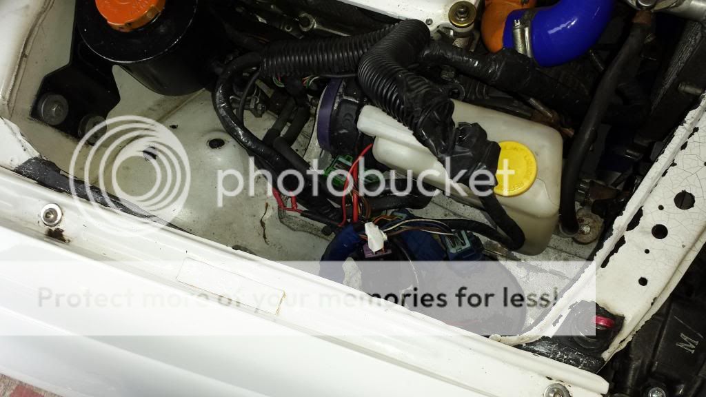

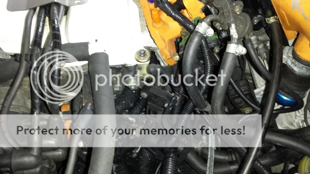

engine bay loom and fuse / relay box cut, spliced, wires twisted together and shoved through a hole into the wheel arch with no arch liners in place allowing water into every thing and causing all sorts of electrical problems.

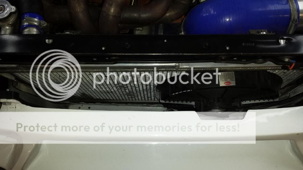

only one rad fan and it only work on a switch. OH nice earth to the right of pic, the one with the RED cable.

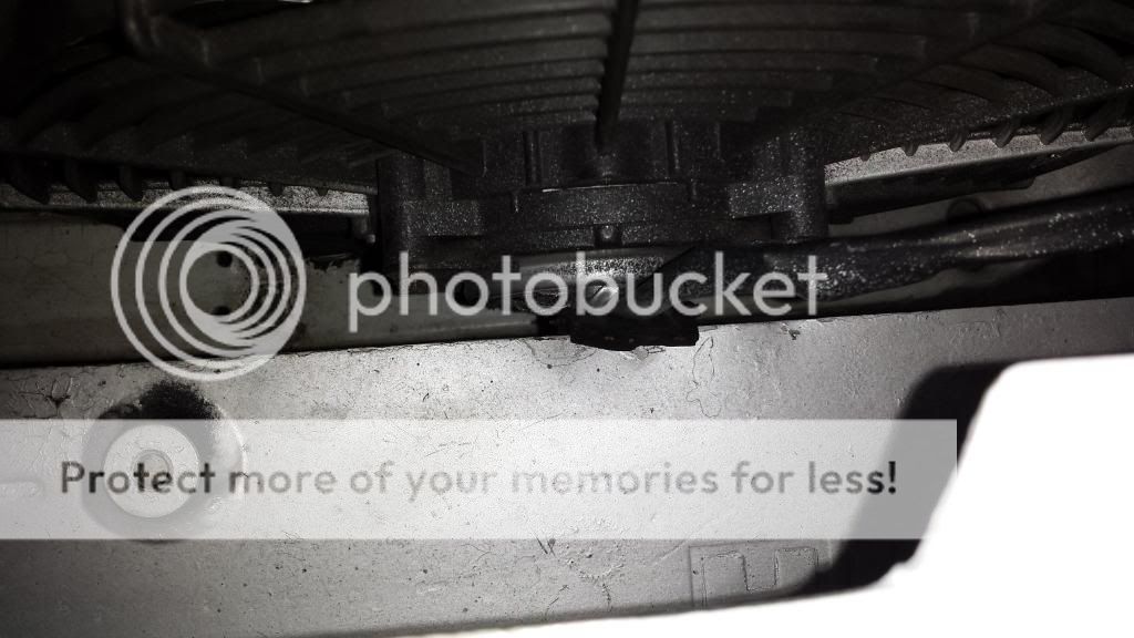

The one rad fan that is fitted is jammed in between the rad and the inter cooler but don't worrie the guy that fitted it made some space by taking a hammer to the inter cooler and making a nice dent to accommodate it and jamming a pice of rubber in to stop it rubbing.

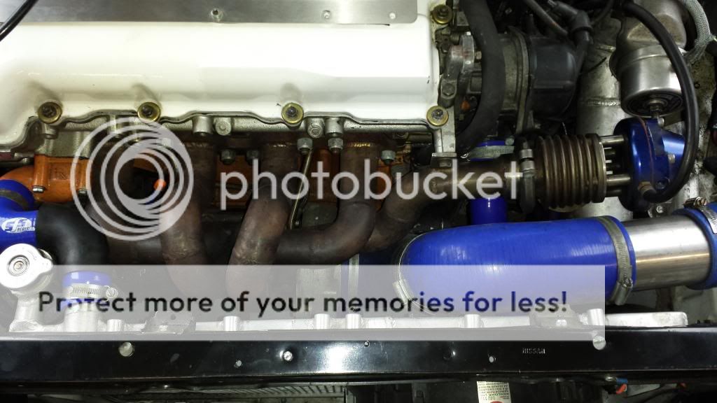

Could have done with a bit of rubber to stop this boost pipe rubbing a hole in itself against the batterie bracket.

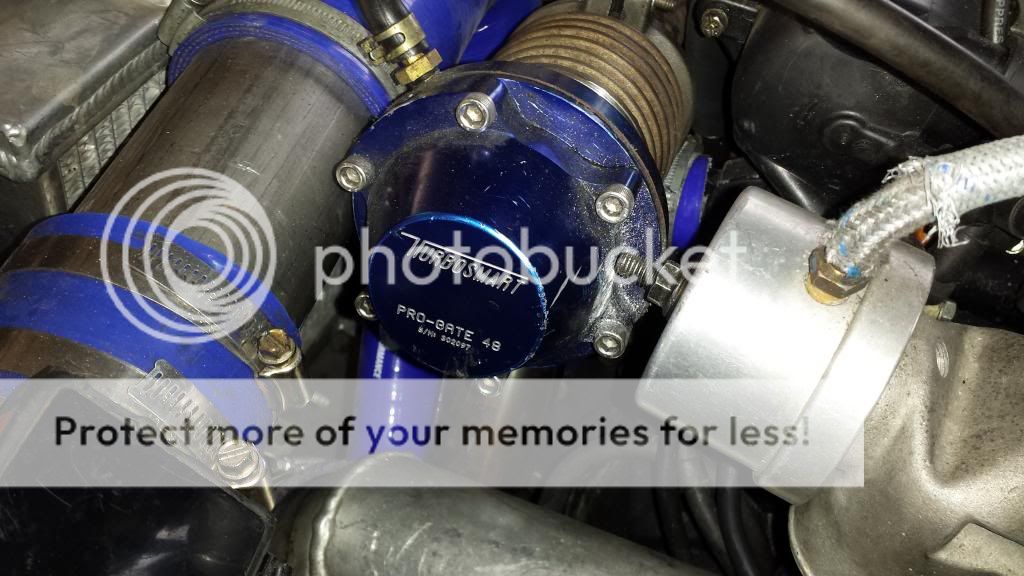

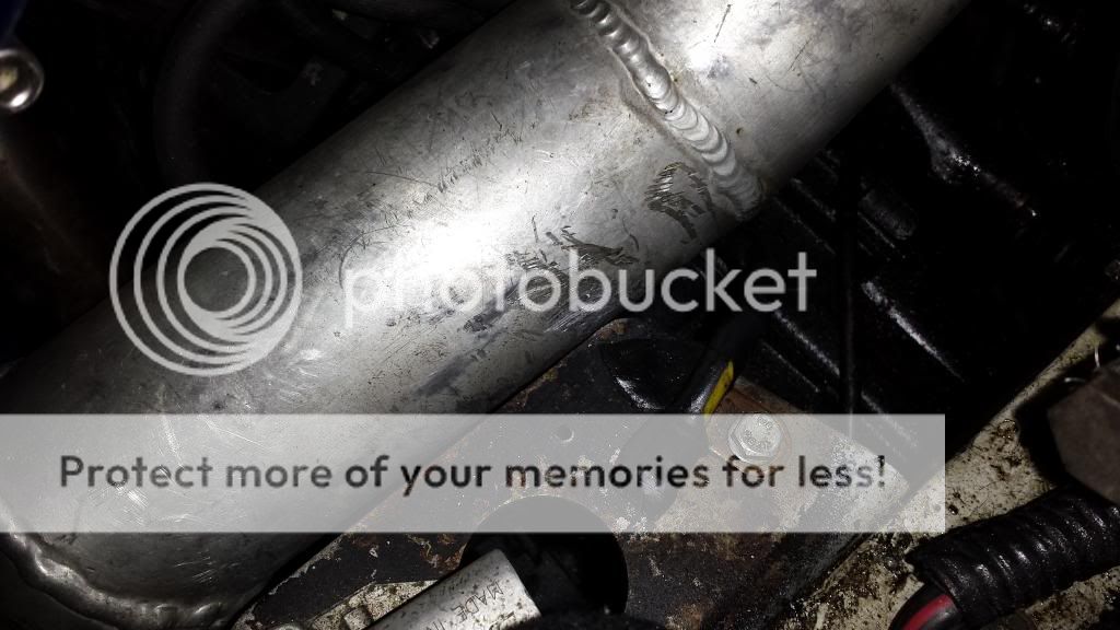

This to could do with some rubber to stop the dump valve eating into the external waste gate.

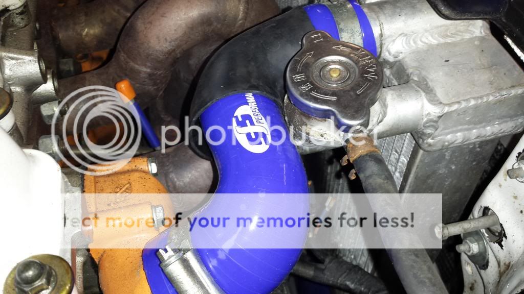

The is some rubber in this equation but it is having a hole rubbed into it by the rad filler neck.

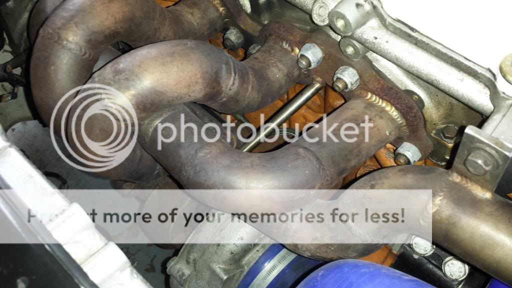

Nylock's are the way forward for securing nearly £2000 worth of turbo, custom manifold and external waste gate.
On a serious note i know the guy behind these great flowing, power proven, nice looking and perfect fitting manifolds. They were sold as DP Manifolds but are more accurately described as Rustle fellows GTI-R manifolds. He still has the jig and he can make them un-gated, gated to fit any external gate if you supplie the gate flange and in T2 T3 and T4 turbo flanges.
