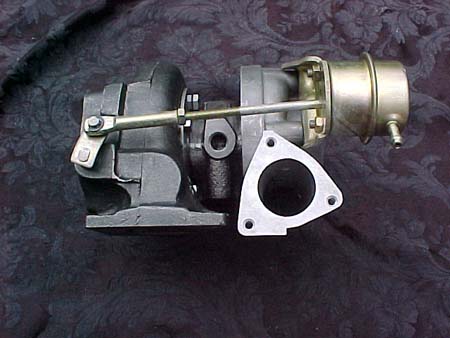

Hi there, I bought this turbo from Ebay, but I need to turn the housing so the point where the
air is going out of the turbo into the engine is facing up, can anyone tell me how ?

When looking at the compressor housing I only see a sort of blocking ring on the inside of the housing...
it doesn't have bolts like this one does :
There's normally 6 or so bolts holding the compressor to the core.remove these and it will rotate.You'll need to fabricate a new mount for the actuator to go on though as it won't line up with the original after you rotate it.Be VERY careful though as you don't want to knock it over and have the blades touch the insides of compressor.

I know there's normally 6 bolts that hold the housing, but I can't find them, they should be on the inside of the compressor housing.
Well, as you guys can see from the pictures, this one hasn't. Any other ideas ?

Actually, there weren't any bolts on the compressor side.
I removed the turbine side with the 4 bolts, so I had enough space to take out the big blocking ring on the inside of the compressor housing. After removing the ring, I could easily take of the compressor housing, turn it 90 degrees and put the whole turbo back together again.
I've also welded a new bracket for the waistgate actuator, it's drying from the paint in my shed right now :)
