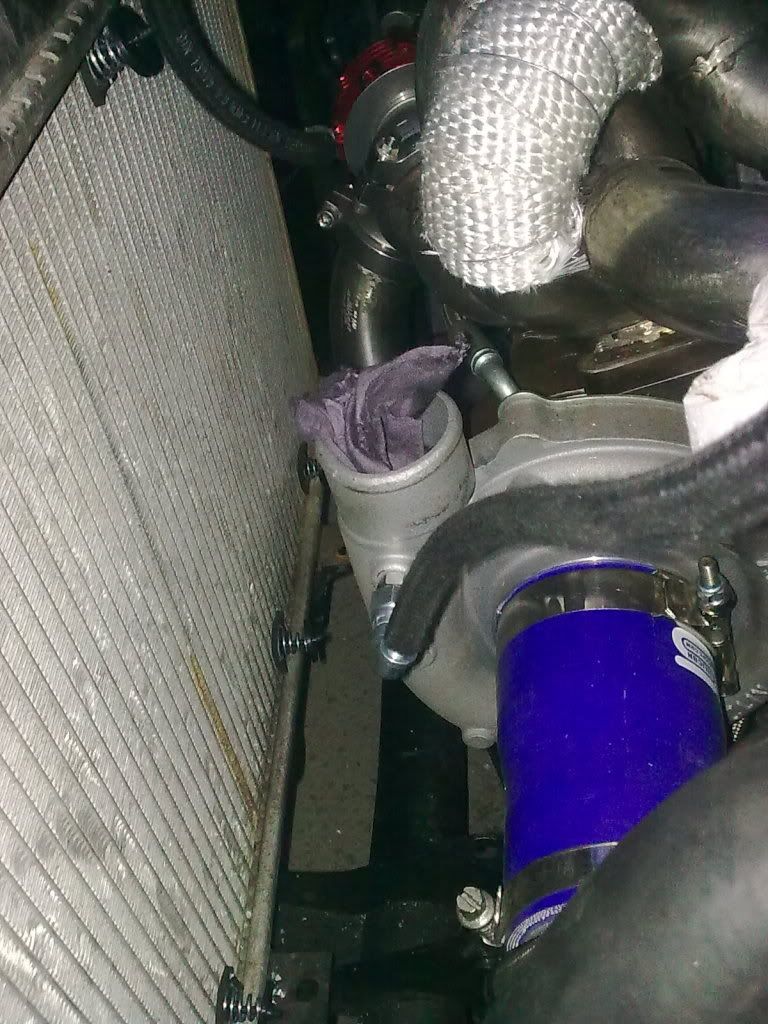

Lately I have been struggling to get right this ''pressure only source'' for your external wastegate controlled by an electronic boost controller.
So....here we go.
First of all you need to pick from the spare''buttons'' you have on your compressor housing (if you don't have those spare ''buttons'' you can go along and pick a spot on your compressor housing and just drill it).
Then you need to drill a hole and make a thread to suit your tap.

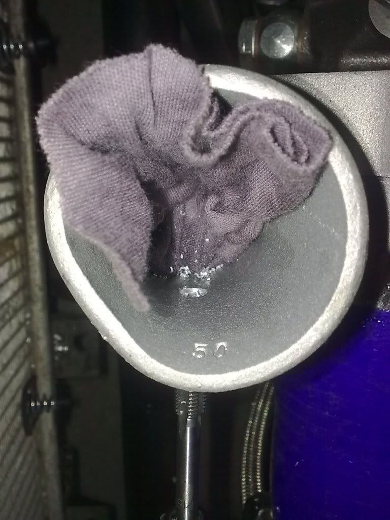

don't forget to protect your turbocharger from the flying aluminium bits that will result from drilling and threading

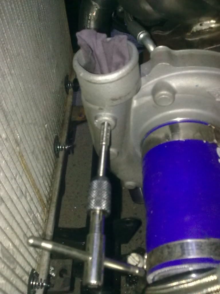

Then...just thread your tap into position (I used the tap form the external wastegates water cooling)

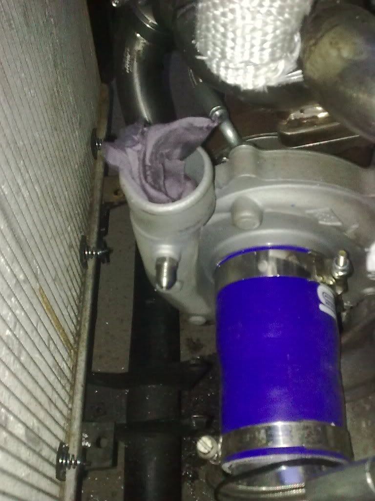

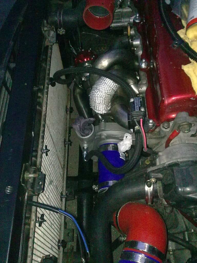

Then...........''voila'' here is your pressure only source connected to the boost controllers solenoid and the external wastegate
