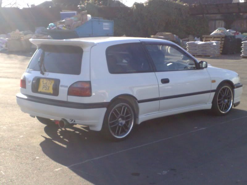

Hello, I've had my car nearly 2 years now and the front left shocker is leaking. I've measured from the centre of the wheel to the wheel arch and it is 300mm's on the front, and 320mm's on the rear. Does anyone know by how many mm's the front and/or rear is lowered by??

Thanks guys, yes, its very low. I'll try get some pics up for you, I struggle to get access to a computer that's my only problem! I had to roll the front wheel arches too but it looks cool! I'm having trouble accessing the web page that olliecast left me though ..... http://www.gtiroc.com/forums/showthread.php?t=42197&highlight=setting+handling .... it says I might not be allowed to access it and wont let me in! How much have your pulsars been lowered by and what's the distance between the centre of the hub/wheel and wheel arch?? maybe I could work it out then!

Thanks. That's all I needed to know! I guess its sitting a bit low then, I'll bear that in mind while sourcing another set!
