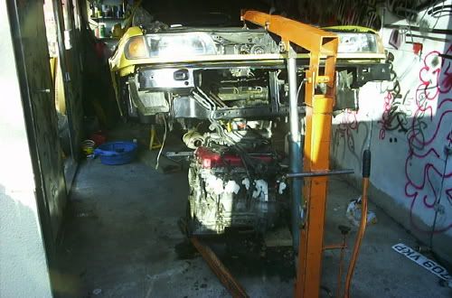

to get it out the top you are going to have to cut an awful lot of the front end off first mate :shock:
comes out the bottom as carl says, lift the car from a suitable point with the crane when the engines on the floor, then use decent size axle stands on the arb mointing point to keep it high enough to get the crane out the way then drag that b@star@d out

Cheers Kieron, nice pic. I was curious as to how high the crane would go but obviously it's enough!
