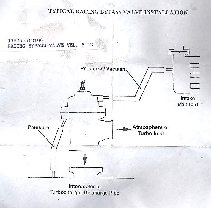

basically I'm removing my forge dump valve and fitting an old type HKS one, the HKS one has 3x connections, the forge one has two.
the big hose is obvious, the other on the forge goes to the plenum, any idea where the 3rd connection on the HKS one goes to?

any of you guy running an HKSbov, can you tell me where you have plumbed in the hoses?
as all I can see in the top picture is both hose connections are coming from the same source
