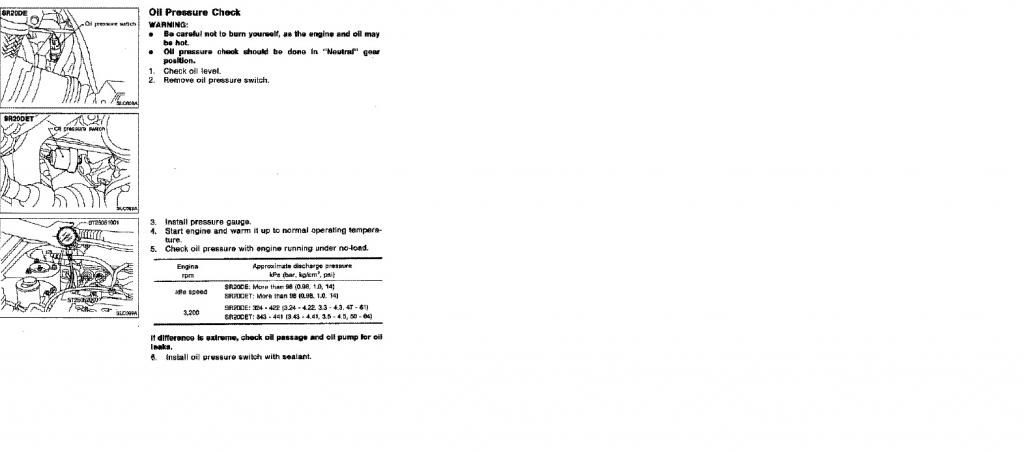

This is how you shall check for correct oil pressure.
If you can't see the values please note that:
Idle speed hot engine: 0.98 Bar / 14 psi
At 3200 rpm : 3.42 - 4.41 bar / 50 - 64 psi
This are values are for the engine with no load (stand still)
Oil pressure is fine if there was an issue you would have oil pissing out of seals or if it was low it would knock the big ends out in no time, sounds like clearences on valves as they do get bigger on these engines as they warm up or could be a blocked oil spray bar for the cams.
