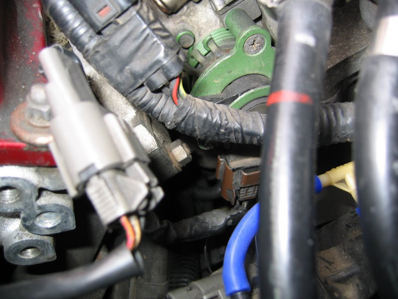

Next thing was to follow Shaun's guide on how to set the TPS. - I thought I was onto a winner with this one because it was at ~0.1V and it took a bit of bashing to get it to 0.49V (and 4.32V when at WOT). I made it easier for myself by finding the grey connector in this picture and just sticking the multimeter probes into the back of it.
The resistances were all spot on, so I'm happy it's working as it should. Idle is still the same.

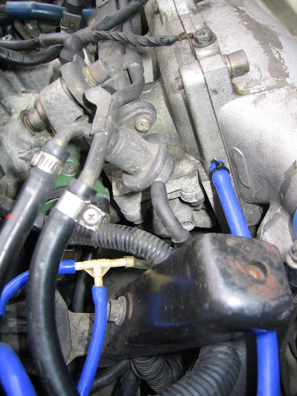

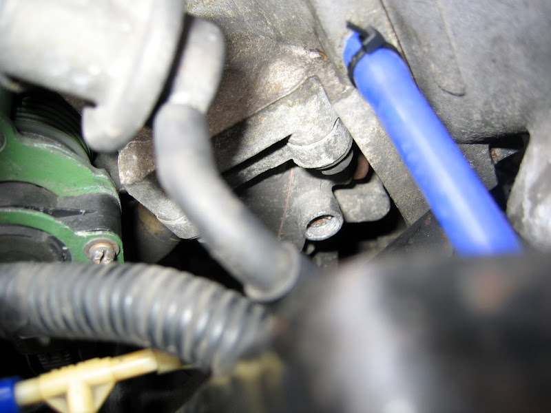

Firstly; is this my idle screw? It does have a hose on it like people describe, but it seems to be in the right place.
Here's a wider shot.

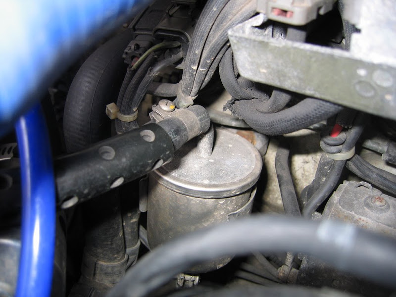

Seeing as I had the multimeter out, I thought I'd do a spot more of electrical checking. I was trying to follow the service manual instructions (here), but I'll be damned if I can find that harness!
Am I looking in the wrong spot? I assume that's a picure of the fuel filter, but this is what I've got:
No harness in sight! Where might it have gone to?

george! in that second picture down, the idle speed control screw is sitting in between both those pipes around an inch below (not inside the pipe which is the main throttle body vacuum)
now before you do anything else....spray that screw with some wd40 and try adjust the idle speed through that.
Thanks - I'll go and do that now! - I thought it might be, but I keep reading about this bit of pipe you need to follow to find it.
It does look like someone has messed with it before because that white paint has gone.
yeah not all have the short bit of pipe on them (its only a guide for your screwdriver, nothing more)

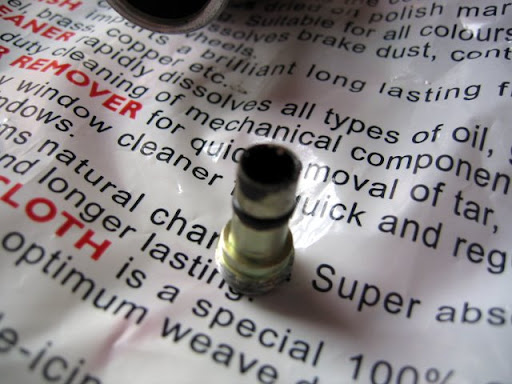

I've taken the idle screw out, and it looks like this:
Lots of black gunk on the end of it; so out with the throttle body cleaner! I've sprayed into the body as best I can, and I've coated the O-ring with some silicone grease (although to be honest it's not in bad shape).

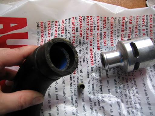

I also took the BOV off: Is this normal?
Looks like it was either the wrong BOV or it didn't have the right fitting kit... anyway, I took it apart:
It's only a single piston and spring - I've cleaned it up. The O-ring has definitely been nicked at some point, and shows wear, but it hasn't split. Plenty of silicone grease on that, and back together again.
