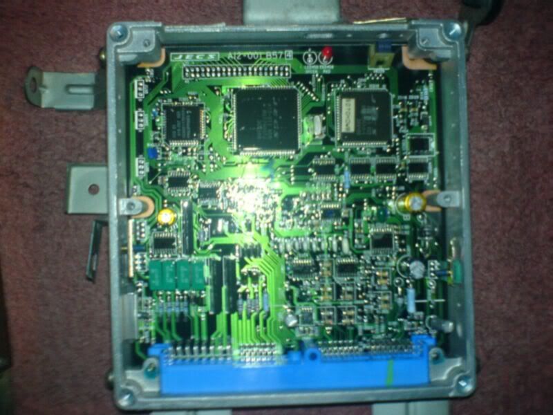

This is my ECU..

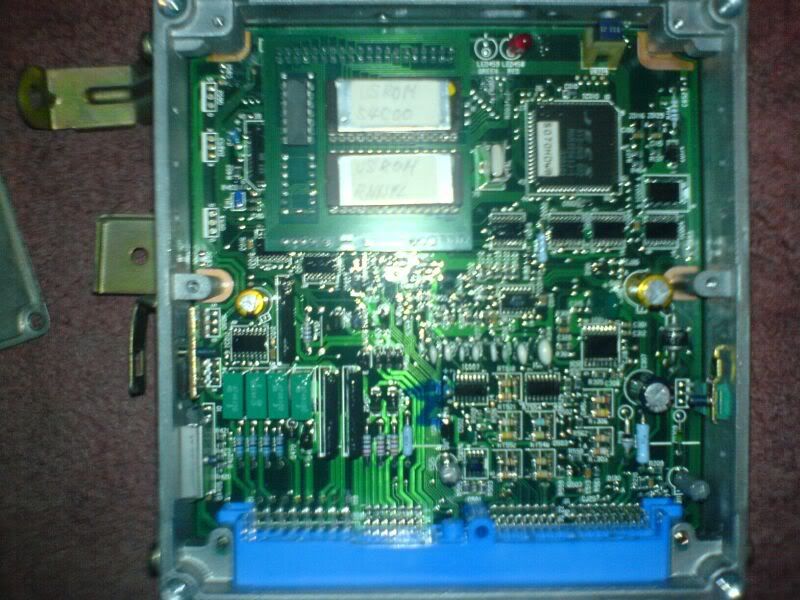

And this is the ECU ive just bought.
The newer one appears to have some kinda extra board already in it!!! The two chips have USROM RNN14 written on them in pencil... Whats goin on here.!!

This is the one that i recently sent out isn't it..?
ECU will be fine just looks like it has a ROM chip fitted... I do have another one spare aswell if you need...? Didn't realise that one of them had a ROM Chip fitted...
