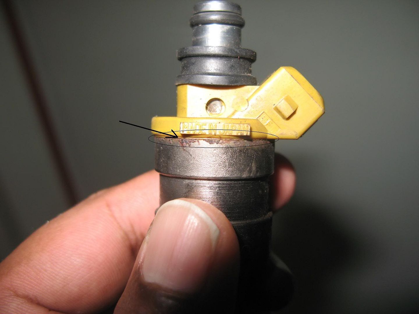

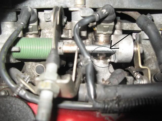

Well I thought it was the top o-ring that was bad - which it probably was (I changed the o-ring)....But now that I put it back up - I see bubbles coming out under the plastic connector :cry::cry::cry: and it is still welling up gas around the base of the injector...
I doubt that this can be repaired? If not - I would like to replace it....What options do I have? I would prefer to go back original.

thats a 444cc injector which is a stock part, just get another one should`nt be too hard to find one, someone will have one on here

this is a common know issue on the pulsar gtirs injectors, i replace them with 4 of skyline gtr cause are the same.
