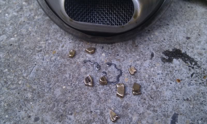

And i do mean bits :lol: My car developed a slight rattle after castle combe sprint on saturday, i thought it sounded like it was coming from the top of the engine but found nothing. So thinking it could be the start of a big end rattle i've just dropped the sump to find these in the strainer on the oil pick up. The lumps of metal look like brass but i can't think where that clip comes from?

They are the circlips that hold the bearings in place for the turbo shaft on a t28 and the other bits are a broken up thrust bearing
Just googled T28 thrust bearings and your right. The thing is i've had a Gt series turbo on my car for ages now and the only time i've had a T28 fail on my car was at least a couple years ago now. Those bits must have been in the engine for ages :shock:
I'd worry about how much of it thats not there has gone thru the oil pump! i have seen this happen on a ball bearing turbo too and that KO'd my mates engine as the broken up bearing parts were small enough to get thru the oil strainer.
Yeah i think realistically the engine is going to have to come apart now just to make sure theres nothing else hiding anywhere which is a pain as Wiscombe hillclimb is only just over 3 weeks away :doh: I've just got the main part of the sump off so will pull all the big end caps off in a minute and see if theres any damage.

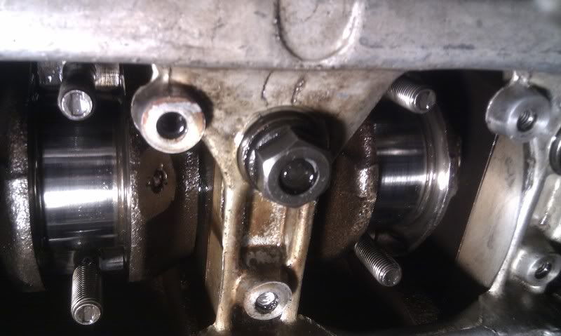

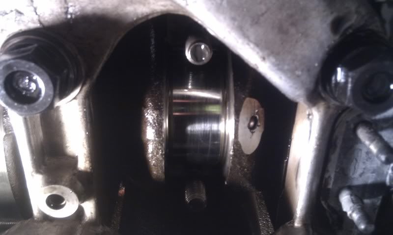

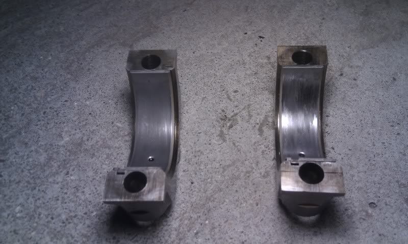

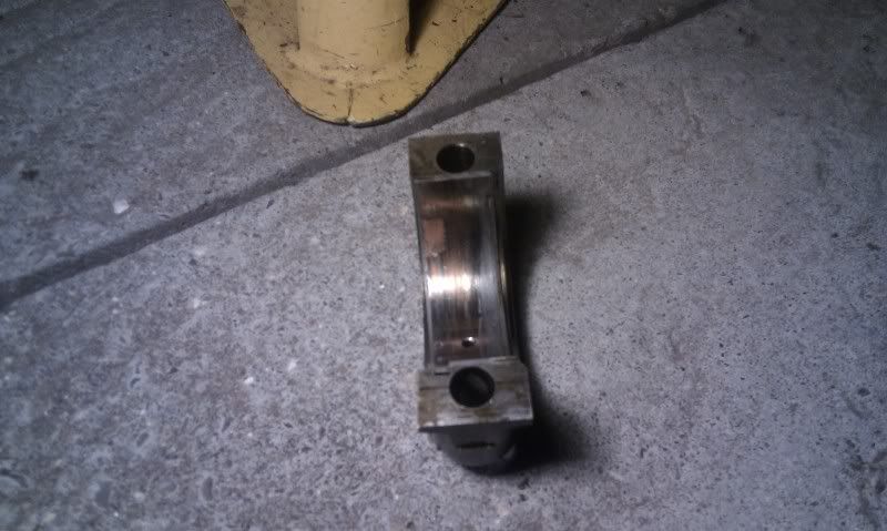

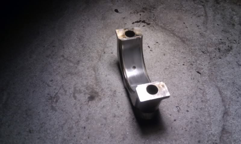

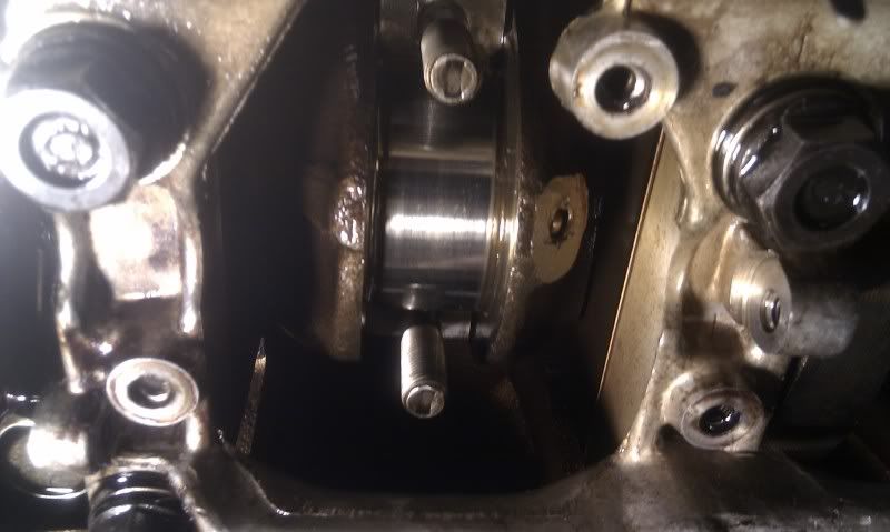

Just pulled all the big end caps off and 3&4 are damaged, the crank dosen't look too bad though apart from a slight mark on number 4 but i guess i won't know for sure until i get it off and measured.

How long do you think they were in your engine for?
Must be 2 years + how no damage has occured until now i don't know :lol:
you may be lucky mark and get away with a new set of shells seeing as theyve not spun.
oil pressure doesnt always drop with bigend probs, check the oil squirters to the pistons also as there a bitch for blocking up which can create misleading oil pressure also the retaining bolts that hold them in situ can seize up which once again causes false raised oil pressure.
