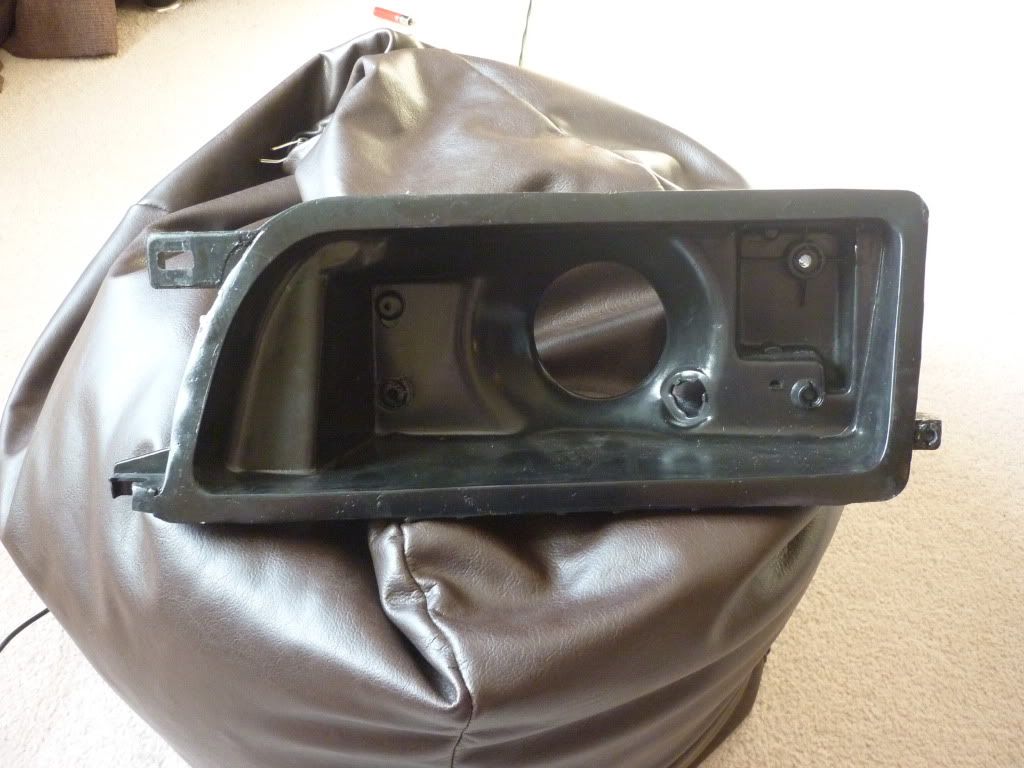

waist of time buying that off ebay, just get yourself another headlight and strip it.
bung it in the oven till the glue goes soft pull the lens off remove all the glue,remove all the shiny shit in side, cut the back off with a hacksaw, i used the round line on the back as a guide,
i then filled the lens groove with 2-pac fiberglass sanded it flush and painted it black

johnsy do you have any pics of the finished article :))
