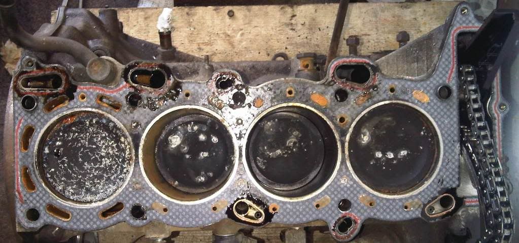

If you are doing a build it is always best to get the head and block skimmed to fit mls gaskets. if that is the engine in the pic above you are fitting the gasket to i would check/renew the pistons as it looks like det damage on the crown.
mikeyp
nah the picture was taken from another topic from somone else that was wondering about thier engine.
my pistons are fine with zero damage and the head gasket was perfect.
