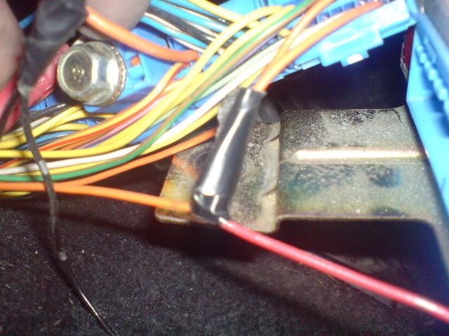

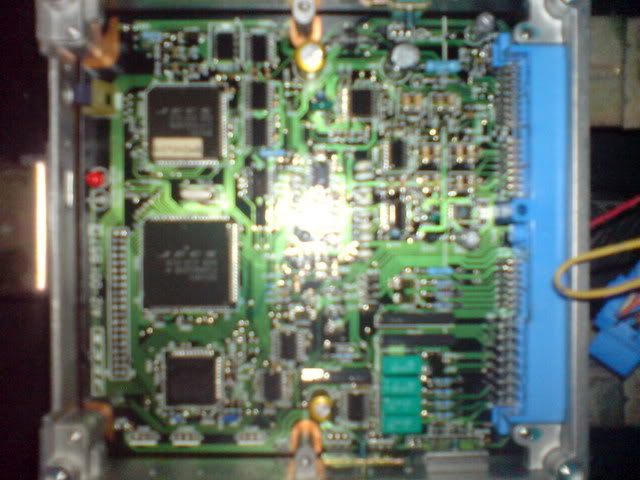

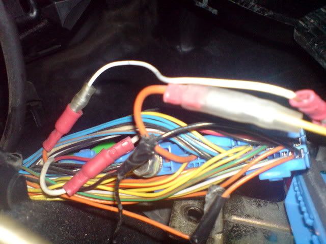

Ok as ive said in other posts,when i bought my pulsar i was told the standard ecu had been remapped.Removed it 2day to have a look but i couldnt see anything obvious as to suggest it had been re-mapped.So i took some pics.I couldnt get it right out as there was a wire coming from under the ecu and it was spliced into another 2 wires.There is also other wires the come from the main plug that have been cut and joined and others added on.Are these normal??Or are they for sumthing else.Hope sum1 can help.

Looks like a standard ECU to me mate, no idea what's going on with your wiring though!!
Do you have an SAFC, narrowband A/F gauge or anything like that in the car?

Nope only got boost gauge and turbo timer.It has had other stuff installed tho because there is tiny screw holes on the side of the dash(next to passengers knees).
Next step will be to follow the wires and see where they go.But it looked like they came back into the ecu loom.Maybe not tho.

by the looks of what wires have been spliced i would say that its had an safc installed at some point or some other type of fuel controller for sure...as for the ecu it looks pretty standard in there:roll: i think that if the standard ecu has been messed with you would see a daughter board or a chip that would stick out from the rest..?

The ECU is standard.. Normally when you remap the Standard ECU you need to wire in a Daughter Board for the mapping alterations.. May have had something wired into the loom in the past..

oh and from waht I understand, on the standard ECU there is a jumper to make it read from its standard chips or an external source, this external source is the 40 pin connector/solder pads on the left of your first pic. if it was messed with it'd have something connected to that. ie like a MINES ecu has a daughter board hooked onto them.
