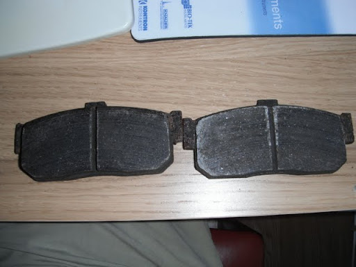

This is what the pads look like (inside on the left, outside on the right); slightly uneven wear...

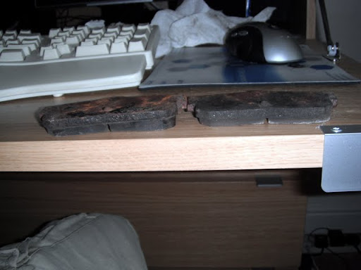

...and this one looks like it might have cooked a bit. :doh:
Anyone know off-hand what thickness the disc should be? I might as well check that's still OK whilst I'm at it.

If the sliders were sticky you should give them a good clean up with some emery cloth. You can wrap it round a pencil or similar to clean out the female side. The rubber boots should also be clipped on both sides. Chances are they are split though.
What is the boot on the piston like? If its in good shape the piston is unlikely to he seized and giving the handbrake mechanism a good clean and lubricate should help.
Also make sure that the little nub on the pad is inside a groove on the piston to stop it from spinning the piston as that won't help matters.
All the boots look pretty good; they don't seem to be split anywhere. - Maybe brake cleaner is the order of the day.

What's the mileage out of interest? More likely wire brush and grease are your friends here..
