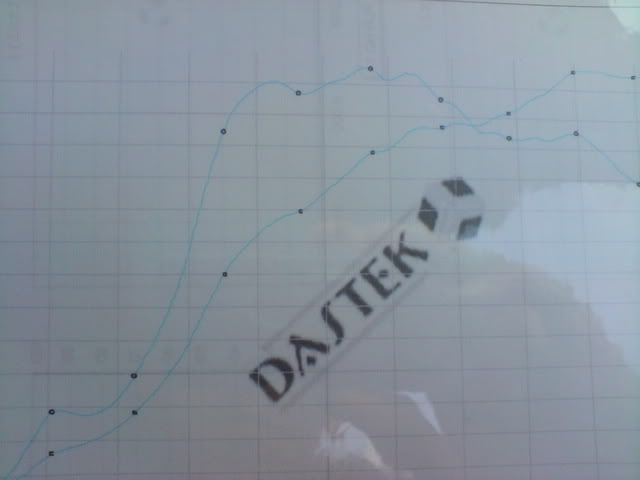

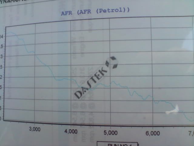

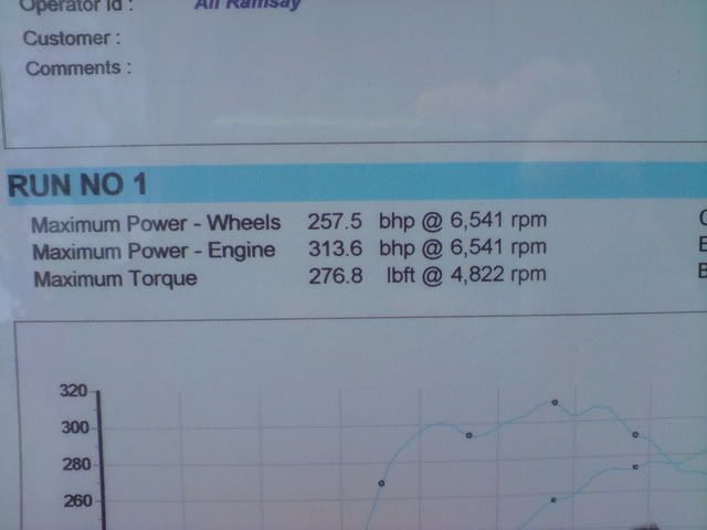

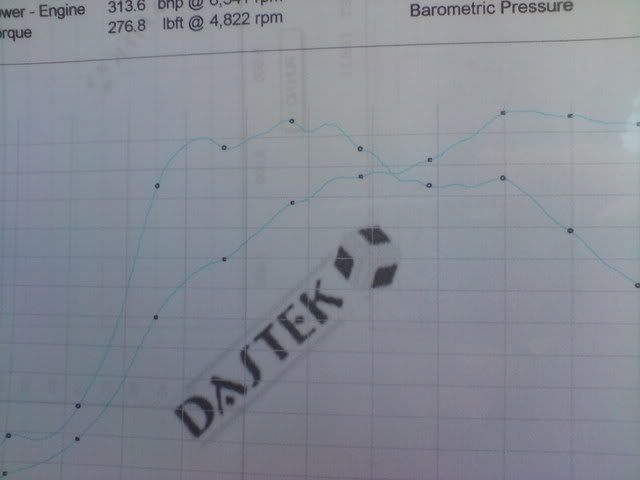

Heres some pics of the graphs.......
The operator said it was pretty good figs for the mods and that its now runing safe AFRs.
Also got the run for £35 even tho they had it/worked on it for well over the hour that it was booked in for.
Let me know if all seems well.Cheers.
