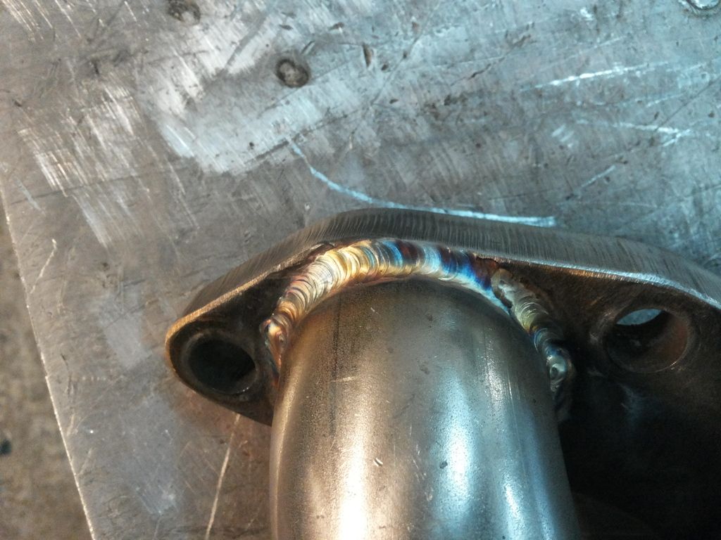

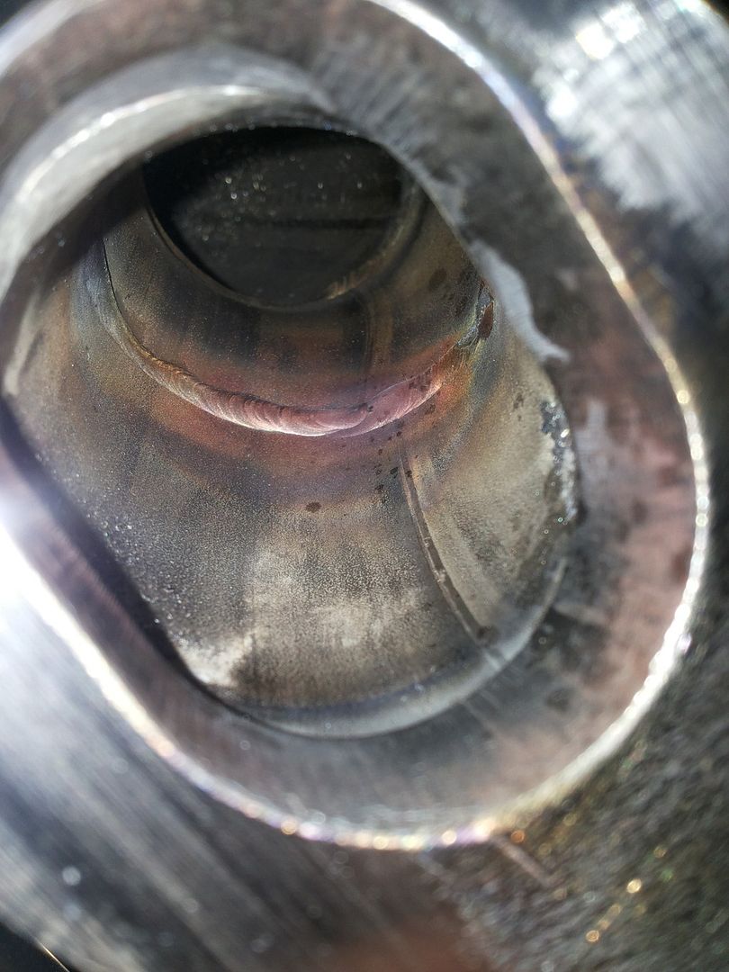

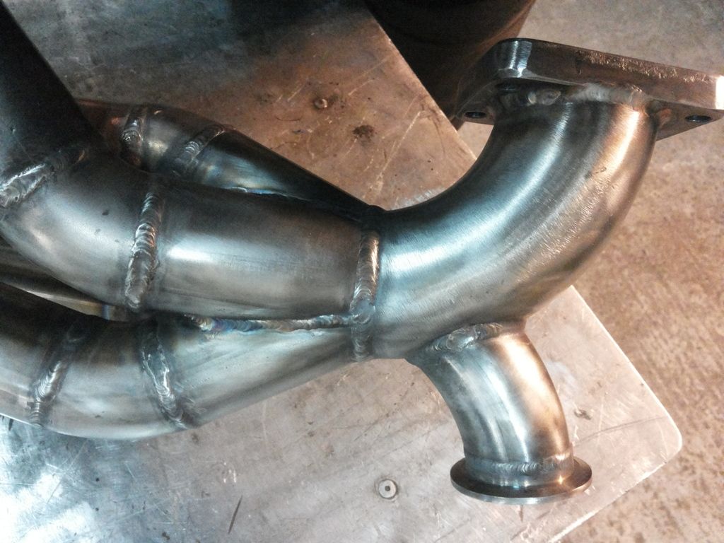

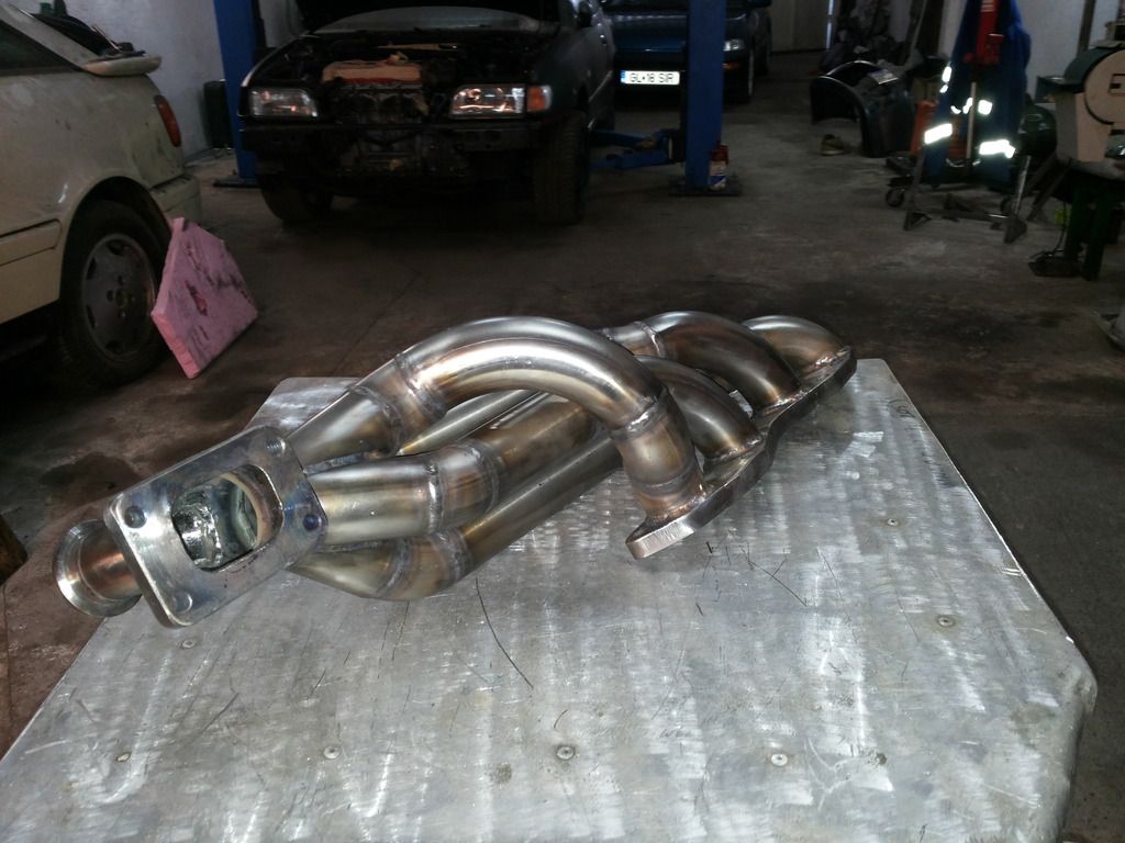

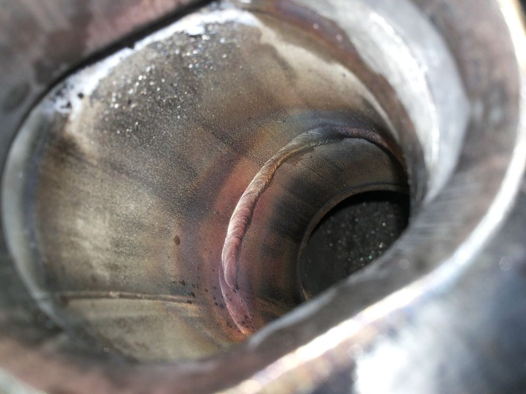

......So the time came to make a manifold for my car......so.....I came up with this.
R RO_SUNNY Active Member Mar 20, 2015 #1 ......So the time came to make a manifold for my car......so.....I came up with this.
keastygtir Well-Known Member Mar 20, 2015 #2 That looks good! Have you got any turbo elbows at the moment?
Fast Guy Moderators Staff member Mar 21, 2015 #5 Get a Borg warner Is that manifold flange the same thickness as standard? It looks very thick in those picture.
R RO_SUNNY Active Member Mar 22, 2015 #6 I have an t25 flanged GT3071 turbo! The thickness is 14 mm.....I have used it so it will not warp during welding!
