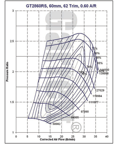

a true garrett gt28rs aka discopotatoe is a 350bhp fast spooling turbo,
theres the comp map for it, the 60mm wheel will never flow enough air for over 400bhp regardless of what flange its on, the wheels aren't bigger enough.
my guess is your mate had something closer to a 2871,
