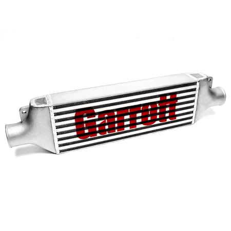

What makes that intercooler bad? What's the best shape intercooler to use? Is it best to use as small an end tank as possible?
I don't like having the inllet/exit on the same side. It is possible to have a good set up but it requires that the end plates are carefully designed to ensure even flow through the core. I am yet to see an aftermarket intercooler with the coonectionson the same side (that like that one) have just used an abitrary angle. Much better to have the connections in the middle of the core with nice radii on the end plates for example:
and if that can sufficiently cool 600hp I'd be very much supprised.
