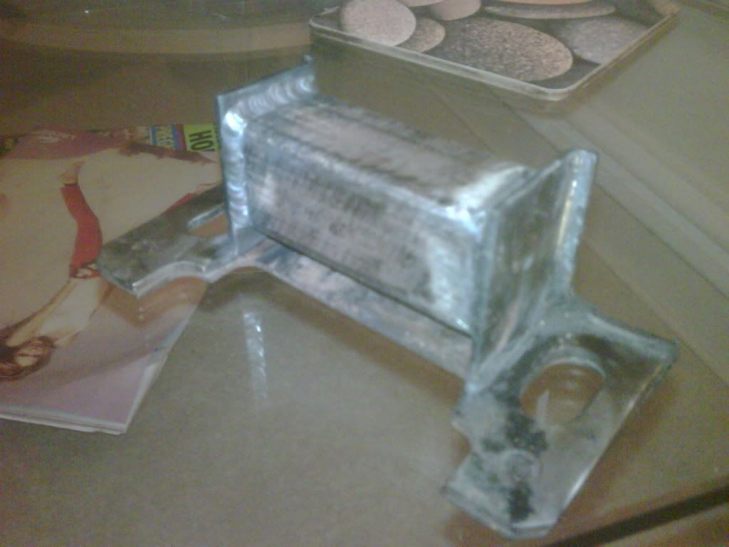

hi it s the one on the far right of the picture with the bolt with the large counter weight on the end , i take it the weight is to try and reduce vibration, , the vibration wouldnt be an issue on a track car , i was thinking of using the original bracket but cutting the rubber of and welding a plate on to the original bracket to make it solid, may be worth a try , i have a spare so can easily revert back to the original if there is any problems ,

No its on now mate. Drilled it on and fastened with the bolt through the back.
I'll try and get a picture later on when I'm under the shitter

hi, ollie tried the mod out on my auto cross car at the weekend with no problems, gear selection more precise didnt miss any gears and no fifth instead of third LOl , nice one , :lol:
olliecast
Brilliant matey :).
Make sure you run a poly stabiliser bush and I turned some ptfe to fit in the arm onto the box. Hardly any noticable play in the stick now
